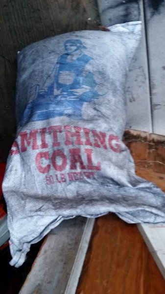

    I use a few different ones. I use Reading anthracite which burns clean but does not mound up. It is hard slippery coal. I use firebrick to mound it into an igloo. I add charcoal to get some really hot coals going, but charcoal shoots very hot embers. I also use bituminus and use a dipper cup with water to wet a ring around the pile to keep it centralized around the tuyere.

    I too tried the hard coal it didn't fair very well at all. It sounded like rice crispies and was constantly shooting hot embers out of my forge. From everything I read is to use soft coal that has good coking capabilities. I just need to find the right suff that puts out longstanding BTU'S. I'll let you know how the Kittanning coal works out, not sure if you have that kind avaliable where you live or not.

    Here is the coal I use. It is bituminous from Boston Coal. Unmarked and unknown what county or mine it is from. It cokes pretty good. I don't wet the mound, just around it.
    Anthracite needs more air, bituminous uses less. If you think you are burning it up too quick, dump some air and see how it goes. Once the mound gets going, I try not to break it.

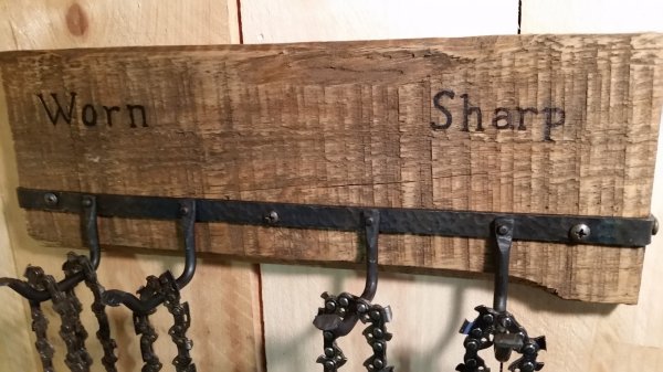

    Here is a chain loop holder I made two weeks ago. I sent this to the Michigan GTG for a raffle prize.

    Look's like it's a 100 years old :thumbs:, and that is meant as a compliment!

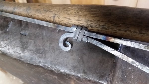

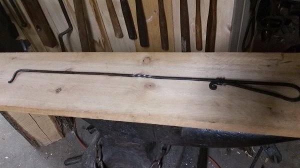

    I made this hook tonight to give to the local 1697 house to close the wooden shutters when they are done for the day. The thick brick walls make it difficult to lean out and close the heavy shutters.
    A single twist to break up the plain shaft. Where the handle loops and meets back, had a little play in it. I flattened out a small rod, heated it red and wrapped it around. A few taps while hot made it snug. When cooled, it tightened up nicely.
    27" long, reverse curl at the hook end, so it doesn't dig into the wood.
