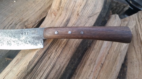

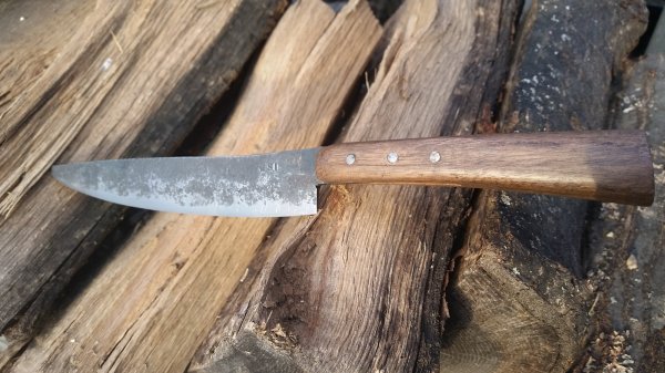

    I finished the second English trade knife. Walnut handle, half tang, 3 iron pins. Shellac and beeswax finish. The blade is longer than the handle, just the camera angle throws it off. The handle is wider on this one, than my last one.

    That looks great Jon truly authentic! :dex::thumbs: Was that the knife that you were making when your son was making his?

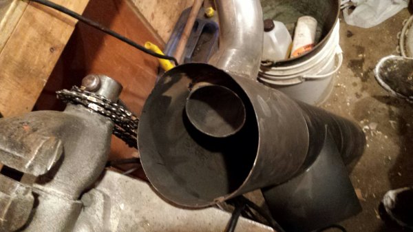

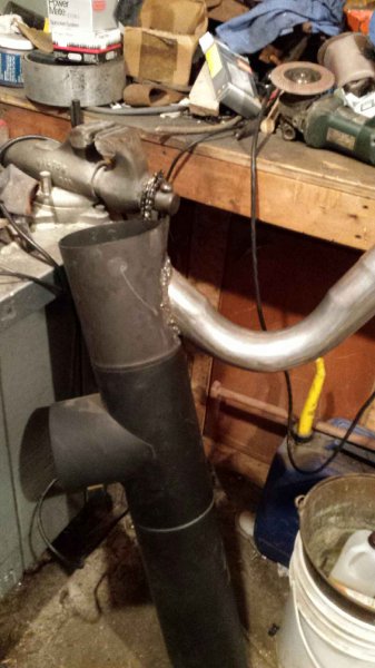

    Here's the start of the pipe for my new draft blower.
    This was all done with the help of Scotty Overkill . Thanks Scott! Now it's just up to get it installed turn on the fan and build a fire.:yes:;)

    I started this one two weeks ago when a friend stopped over when I had the big forge set up outside. My son made his in the soup can forge in the shop.
    The walnut was really nice to use. I was real careful setting the pins.

    That should get the smoke moving up the pipe. Your barometric damper should help keep your stove draft from getting too crazy of a draft.

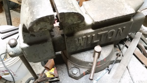

    Nice Wilton bullet vise ya have there.
    I have a regular Wilton bench vise on a metal stand and a Columbian on the bench.

    That was actually at Scotty Overkill's shop.

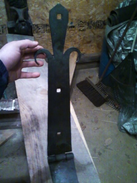

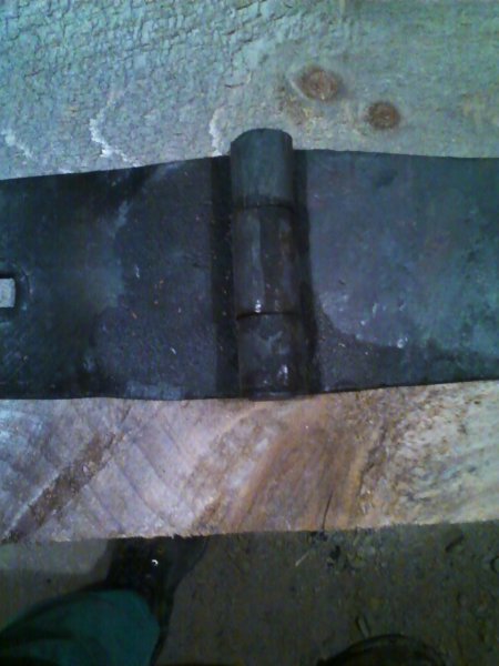

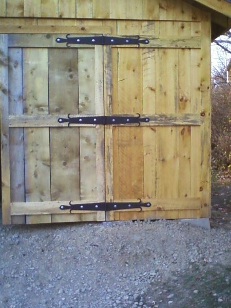

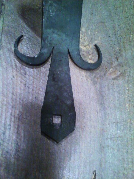

    Here are the strap hinges thatI made for my shop. I think it took me abou 80 hours to make 6 hinges. I used 1/4" x 4" flat stock and 1/2" round stock for the hinge pins.
    Everything was done by hand with the anvil, hot cutter and hammer. I hot cut the taper. And used a square drift to pinch the holes for the carriage bolts. Hand rolled the socket for the pins.
    The doors are 4ft x 8ft and very heavy so I wanted some big hinges. And I knew that I couldn't buy hinges like this at Lowe's.
    The hinges fully opened up are 4 ft long.

    Very nice! I'm glad you mentioned that they were 4' opened up. :thumbs:
    I've been half azz collecting old strap/barn hinges for years. A lot of singles and stuff that's been through a fire but still looks cool. One of these day's I'd like to make a frame of some sort to display them. They are mostly from old barns & farm buildings in the MD/PA area that were too far "gone" to save.

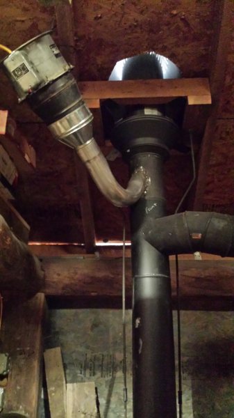

    Finally got the flue put back together and the fan installed. This is one heck of a fan that will really move the air! Here are some pictures.
    I tried it out today and I don't understand there doesn't seem to be much of a change! :headbang::headbang::mad::mad:I mean the fan that I installed moves some major air. I wonder if my spark arrester is helping to impead the flow? The fan is at the top of the pipe above the tee so if anything is pulling from both flues. So in my mind I don't think that there should be an issue!

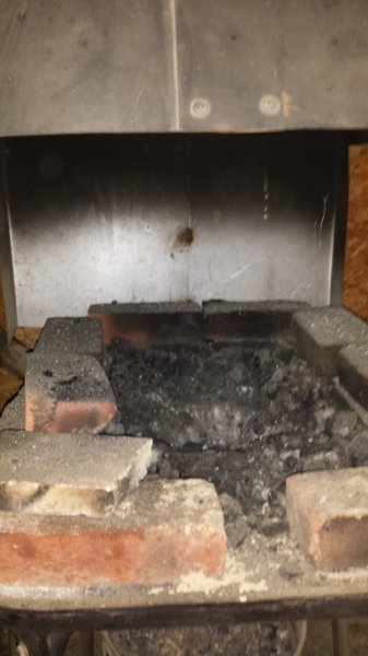

    I wonder if I need to make longer sides on my hood and make it wider above the forge? The bottom of the hood is only about 12" above the fire.
    As you can see in this last picture the back of the hood comes down past the forge in the back. Mainly to keep coals from jumping out onto my wall. I thought that this would also help increase the draw?

    Can you take a burning stick or incense stick and hold it around in different places. Start up under the hood and lower it down to check the draw.
