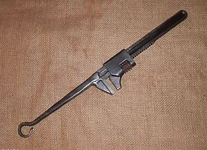

    Take an adjustable wrench and weld some steel rod opposite the handle. It helps greatly to even the twist. I've quenched either side of twists to keep it contained to a particular heated area of the stock. There is a bit of satisfaction when the stock is soft enough to twist and it cooperates.

    That is exactly what I plan on doing. But one problem I only have one wrench like the one in your picture but it's a smaller one. I'd like to get a couple of different sizes and haveat least two wrenches in each size I can twist different sizes of steel.
    I suppose I could go to flea markets or check ebay for these wrenches. Just something I've never gotten around to.:picard:

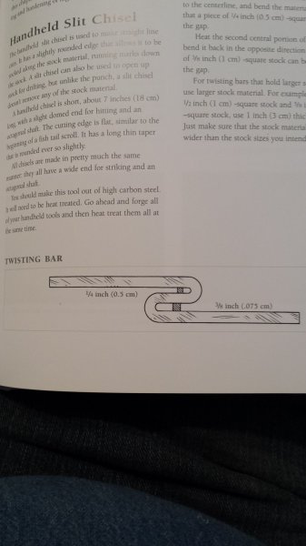

    I also hate to deface an old wrench as well. I have seen something similar in my blacksmithing books that you use square stock. Here's a picture. I just don't know how well something like this would hold it's shape and stay tight when you would torque it to do the twisting . I suppose if you make it out of heavy enough square stock you'd be ok. Again something i haven't had time to mess around with, one of these days!

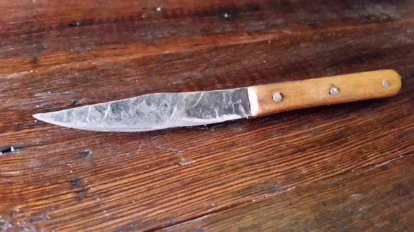

    The pins were a little too long on my son's knife and bent when I was peening it over. The scales are from pallet wood, possibly mahogany. Thin wood is not too forgiving. I cut and set the new ones already. He will sand and finish it today I believe.

    He was fine. Kind of that eye roll, "really dad?" look. He'll be 11 soon.
    He asked to go to the scrap yard this morning before they closed. We picked some nice half inch thick allen wrenches for a few bucks. I think this will be the next step up. We'll pick some coil springs next time.
    He finished the knife. I used shorter pins and filed them close to the scales before peening.
    Lots of errant strikes but he is learning the angles of the hammer face to the metal.
