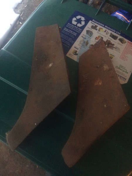

    Was just out in the barn and figured I'd snap a picture the top/left one is a new reproduction from the Amish the other is the original that is missing the holding finger IMG_2234.JPG IMG_2235.JPG IMG_2236.JPG

    Did the Amish make it or did you just buy an old one from them?

    For all the bigger they are I don't think it would be to difficult to make duplicates from the pictures that I see. As long as there is one to copy off of to get the angles and contour right.

    I bought them from a guy at our local Deere dealer who said he knew a guy who was Amish that had made some that he could get me so I bought a pair for about $125 this was almost 10 years ago now. Guess I couldn't be sure weather they were bought elsewhere or hand made

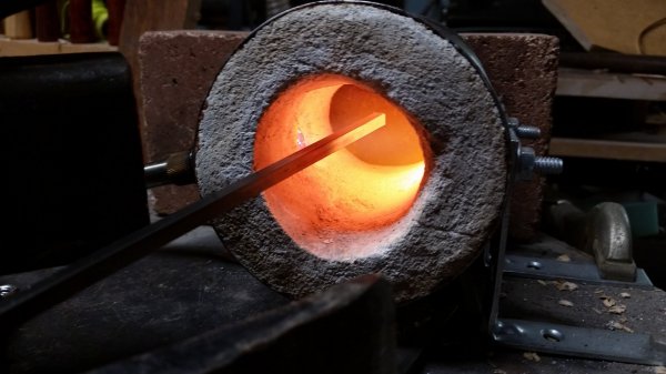

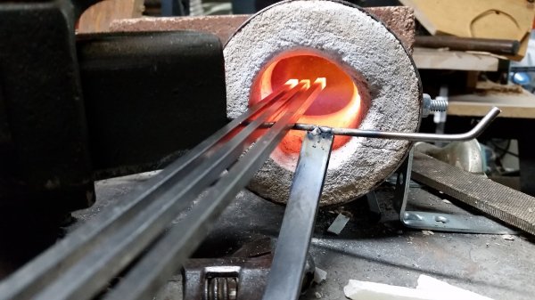

    Started the rat tail meat skewers tonight using the soup can forge. It works great on the small stock. The points and first twists on the business end are done.

    I finished them up this afternoon. I ended up welding some stock together to make a holder for the rods in the forge. It cut my time down greatly and there was always a piece hot and ready to work.
    Into the woodstove for a few minutes to burn the oils off the iron.
    I finished them with food safe finish as they were cooling down. It darkens the iron, helps prevent rust and evens out the color a little.
