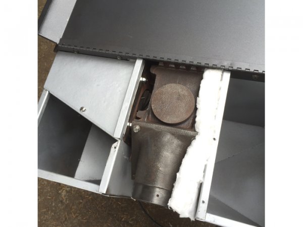

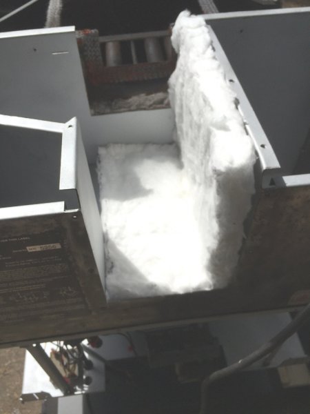

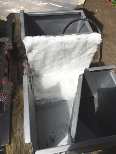

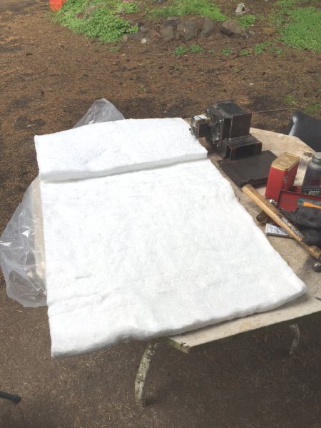

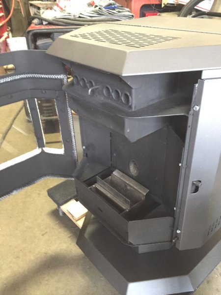

    I unwrapped the package of ceramic blanket and laid out what was needed for the stove, 9-1/2" X 13-1/2"
    Having never worked with this stuff I was not really sure on the best tool to cut it.
    Tried a razor knife first, ahhhh, not so much.
    Grabbed a pair of hand pruning shears and JOY, the shears easily and cleanly cut the ceramic blanket quite nicely.
    Cut the piece out and stuffed it in the alleyway in the stove, Looking good.

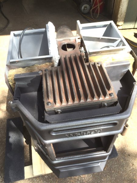

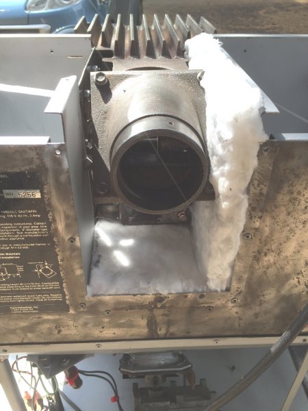

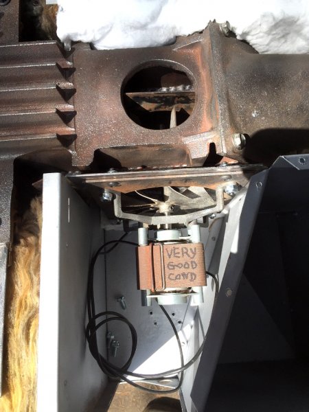

    I finished up installing the rope seal on the exhaust casting and getting the assembly ready to install.
    Had a few little tweaks needed on the fan box as a result of the hack who violated the poor little creature before we got it.
    Installed the proper fan motor venturi ring and the motor and exhaust impeller.
    Bolted the entire assembly to the top casting and then started the tedious task of shoe horning the thing into to alleyway.
    A little iggle and uggle and it was in place ready to be bolted down.

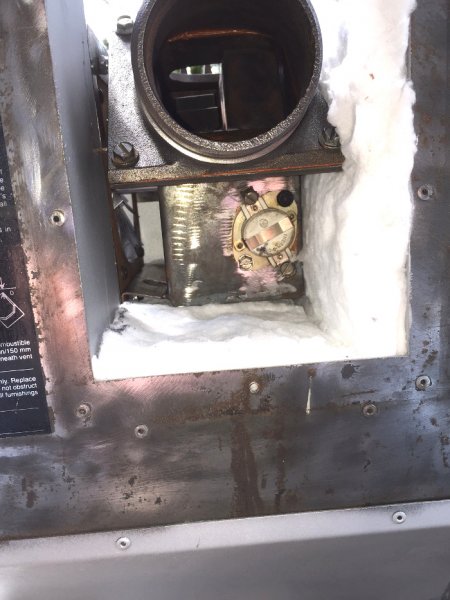

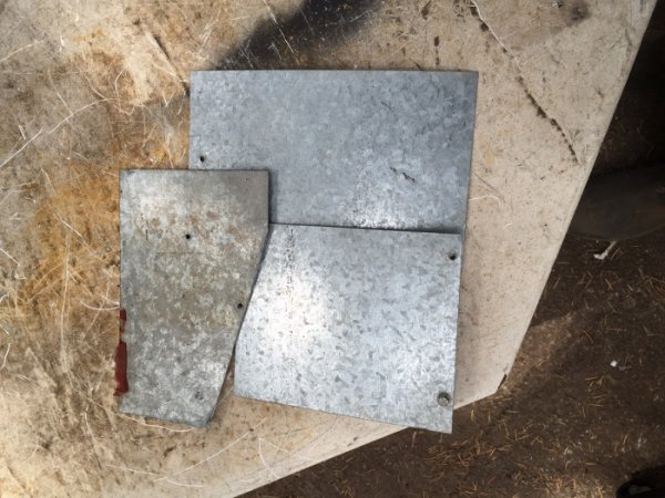

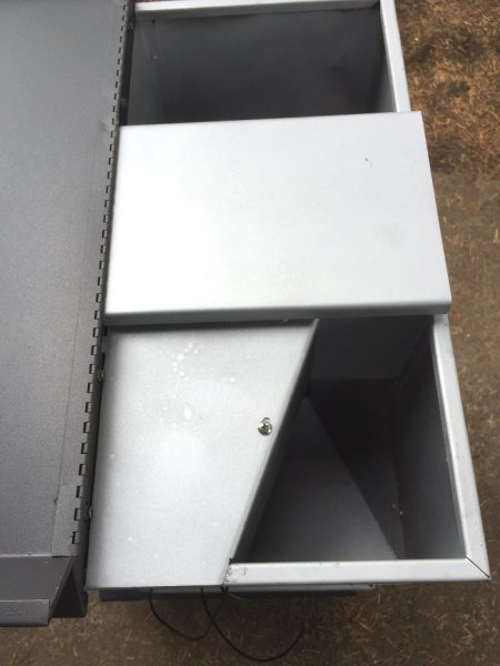

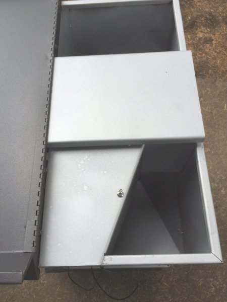

    Attention then turned to finishing the new covers for the casting and the exhaust motor.
    The originals had been removed and after the area was totally violated 3 pieces of sheet metal were screwed down to cover the area :hair:
    That was a mess.
    I copied factory parts as best as could be done within the constraints of available forming tools.
    The original motor cover had complex bends and was likely die formed when new.
    A cardboard pattern and a trip to the local steel shop got the two covers formed.
    One piece on the motor cover needed to be fabricated to end up with the needed flange
    I used a 3/4 x 3/4 x 1/8 angle and cut one side down in the mill to approx 9/16 wide.
    After welding the piece on the finished part closely resembles the factory item.
    Some paint to get the parts matching the hopper and interior color (Flat silver header paint)

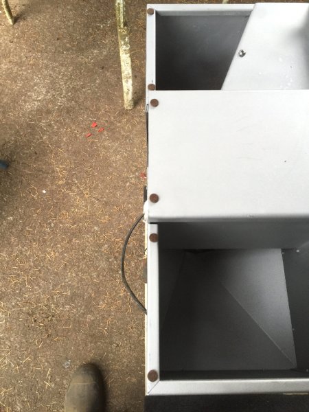

    A bit of attention to fine details seemed like a fine idea as the lid on these stoves makes a tinny clunk when it closes.
    Added some little sticky backed felt buttons to the contact point to give a nice quiet closing sound.

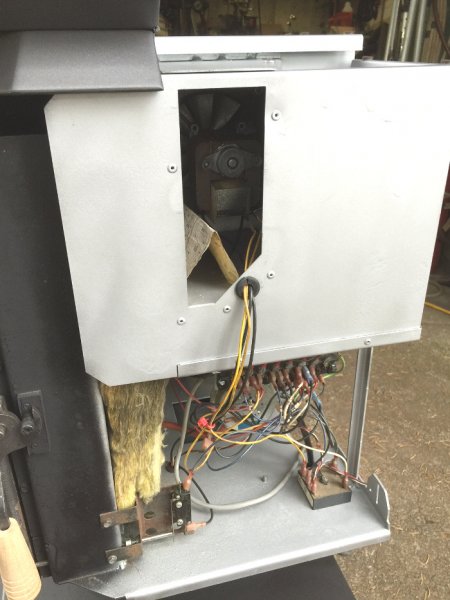

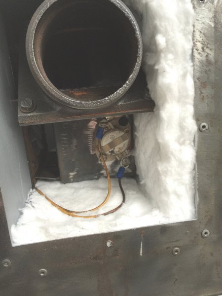

    Finished up the wiring of the low limit snap in the rear of the fan box.
    Fork connectors were in sad shape, so replaced them with new.
    The rubber grommet in the bulkhead was long gone and so stuck in a fresh one.
    Hooked up the fan and tied up the remaining wires.
    The back panel still needs paint, but the ID/serial # tags need to be masked off first.
    The door seal, glass and just a few odds and ends are pretty much all that remains.
    Gotta tidy up the fire pot and ash pan and the firebox area will be complete.
    Should get the glass next week and if all goes well a fire can be tossed in and testing can be done
    Here are a bunch of pix taken during yesterdays session.

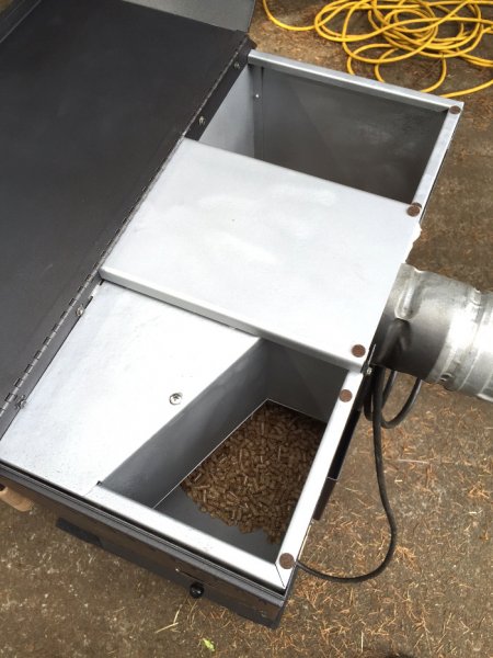

  2. Snowy Rivers
    Snowy Rivers
    Nov 15, 2015
    2,849
    12,491
    Newberg, Oregon
    More pix

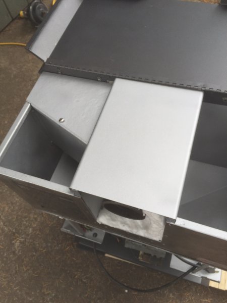

  3. Snowy Rivers
    Snowy Rivers
    Nov 15, 2015
    2,849
    12,491
    Newberg, Oregon
    More pix
    I must say, having a lathe, mill, wire welder and myriad tools really makes this sort of project far easier, and in some instances it would have been nearly impossible to achieve the results obtained.

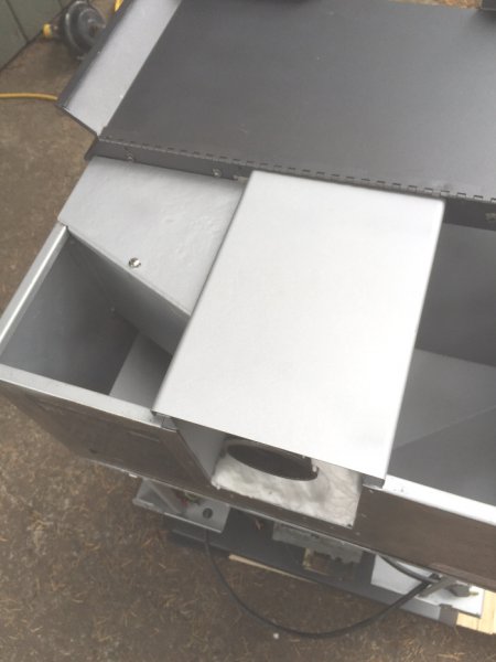

  4. Snowy Rivers
    Snowy Rivers
    Nov 15, 2015
    2,849
    12,491
    Newberg, Oregon
    The weather today sucks, with showers and sun breaks.
    Just get tools out and ready to work and then it rains like crazy.
    Did get a bit of work done.
    Cleaned up the nasty grody fire pot and shined it up.
    Even the stainless steel pot had been attacked by the combination of ashes and dampness.
    Mostly just grunge though and the wire wheel and some elbow grease took care of it well.
    The fire pots woven seal ring was missing and some sort of totally fried rubber ring was in it's place.
    After getting things clean I went to stuff the pot back in with a good ring on the air pipe and the pot will not drop down on the locating tabs.
    Hmmmmm.
    All seems well, but no cigar.
    A little grinding on the vertical locating face to allow the pot to have a tad more room and all is well.
    Then the rains came again.
    Decided to call it a day.
    Need to paint and this weather is not gonna cut it.
    Tomorrow is suppose to be better

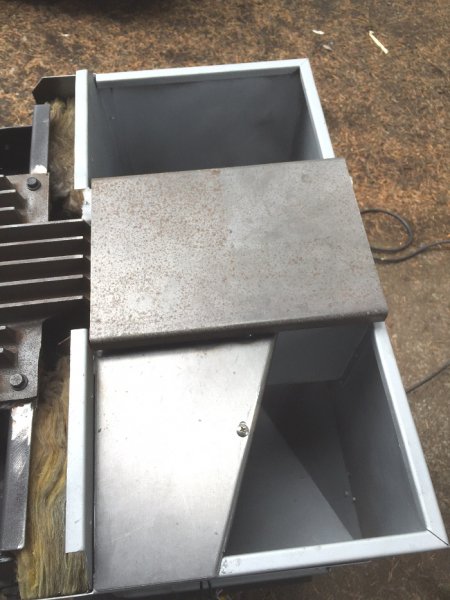

  5. Snowy Rivers
    Snowy Rivers
    Nov 15, 2015
    2,849
    12,491
    Newberg, Oregon

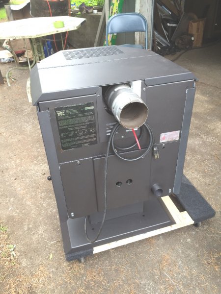

    Better weather today and work is progressing again.
    A paint job on the back of the unit and some touch up work on a few spots that showed some imperfections in the bright daylight today.
    Vent trim panel and the rear access panel now in place.
    Still need to paint the control panel door and install it and the controls.

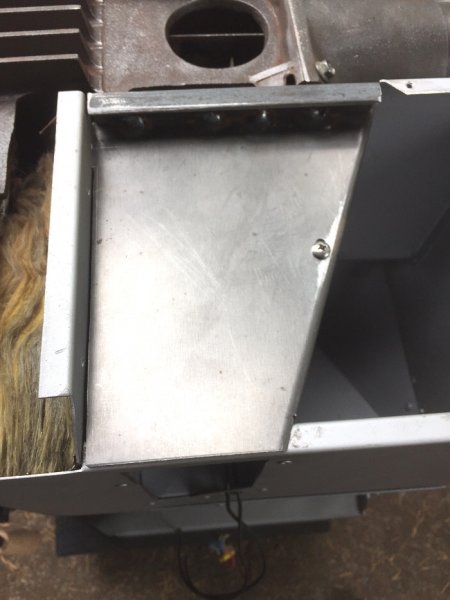

  6. Snowy Rivers
    Snowy Rivers
    Nov 15, 2015
    2,849
    12,491
    Newberg, Oregon
    Finally getting very close.
    Aside from window glass the little beast is almost there.

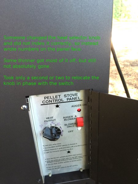

    Got everything done inside and the controls hooked up.

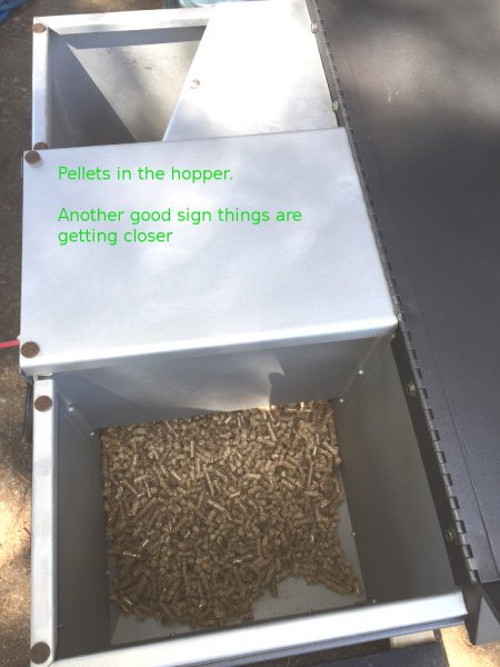

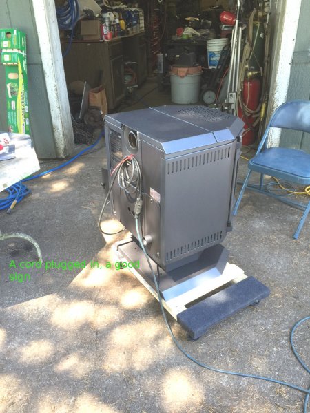

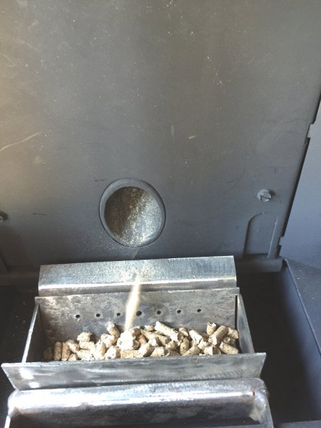

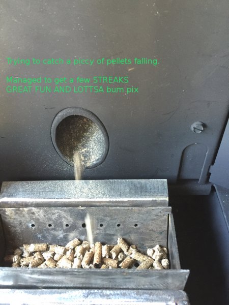

    Decided to add pellets and go for an auger prime up and basically test the feed rates, adjust the fan speed trimmer and generally see wassssssup.
    Having an extension cord plugged into it is a good thing.
    The systems powered right up and about 5 minutes later there were pellets falling into the pot. :yes:
    All the feed rates are correct and things are good.
    As soon as the glass is in we can toss a fire in the little beast and do the final adjustments.
    Now it's time to relax and tomorrow start mowing the grass around here.

    I like the pics of pellets dropping - who knew they were moving fast enough to give the camera fits trying to capture it?
  8. Snowy Rivers
    Snowy Rivers
    Nov 15, 2015
    2,849
    12,491
    Newberg, Oregon
    Actually the biggest problem was guessing when they were going to drop.
    Some feed cycles may drop several and others might drop only one piece or so.
    Then trying to snap the pic so I could actually catch the catch them in midair before they hit the pile in the pot.
    It takes a second or so from touching the "Shutter" button om my iphone 6 plus until the pic is taken.
    The ones I did get I just held the button and shot an entire stream, then sorted through the bunch.
    Was kinda fun.
    Sitting there priming the auger and twiddling my thumbs and got the idea to try and photograph pellets dropping :picard:
    Lack of better things to do I guess. :D

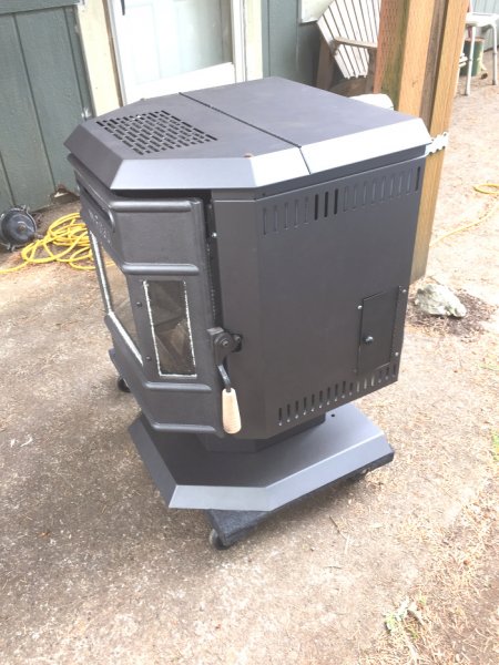

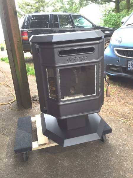

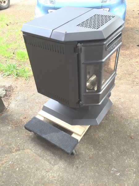

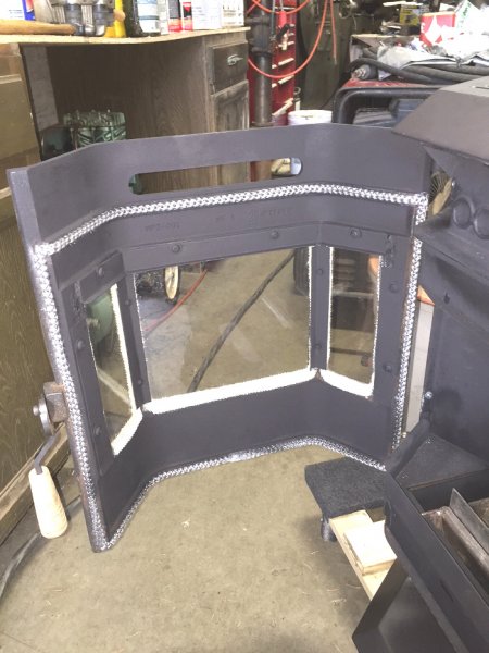

    LITTLE CREATURE ALL DONE.
    Got the new glass today and buttoned things up a bit ago.
    Tomorrow I will toss a fire in the little critter and make any final adjustments to the draft fan and pellet feed.
    Been a great project "GLAD IT IS DONE"
  13. bogieb
    12,552
    76,344
    That looks fantastic. If it burns half as good as it looks, someone will be extremely happy with it!
