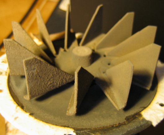

    I used Behold furniture polish on the hopper walls....worked as well as anything else. As for the combustion fan blades, I used spray graphite, as recommended by Mike Holton.....worked great and slowed the burned ash build-up WAY down.
    This was after my record-setting 60 bag run (w/o opening the front door).....blades had been sprayed w/ graphite:

    Ok.. Got my hopper "beholded" up..
    Im optimstic!
    I assume you applie it with a rag. How heavy a coat worked for you.
    Thanks

    I vacuumed out the empty hopper w/ a brush attachment, then sprayed the Behold direct onto the hopper walls.....a good rub with an old rag and the walls were nice & slick. I sprayed the same as if I was doing a piece of furniture.
