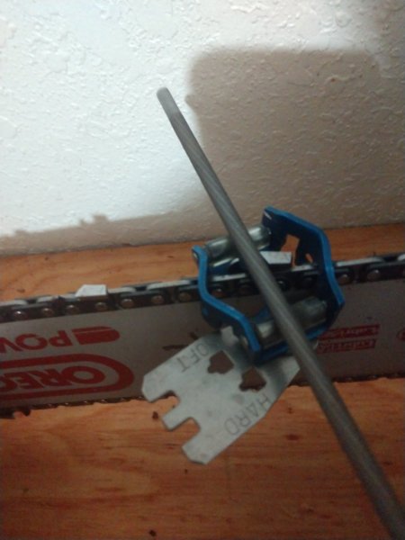

    This is what I use. Blue one is for 3/8 silver for .325. they are made by Husqvarna and work great on Oregon and Carlton chain. They do work on Stihl brand chain also, but a bit more care has to be taken to make sure they are saddled properly on the drive links. IMG_20190721_143708683.jpg

    You got a link for that or know what they are called so one can find them? I have no idea how that would work.

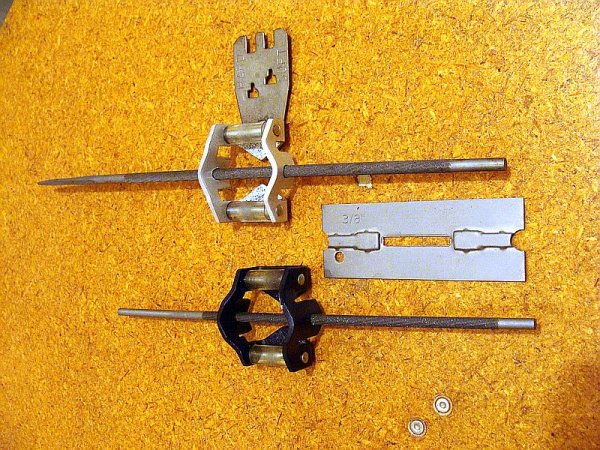

    Here is a video of the small file guide member, tamarack, has shown...
    The web page links I find on it, the word "pixel" is part of the item description and appears to be a type of Husky chain? I don't know what "pixel" means in this regard.
    This is the first I have seen this type file guide. I wonder if this will work for common chains or just "pixel" chains, whatever that is. This Husky gizmo is certainly cheaper than the Stihl 2-in-1 file guide gizmo (2-in-1 costs about $40).

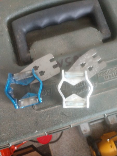

    They work on my Oregon chains and the Stihl RS23. Any Husqvarna dealer should have them. Note that the .325" narrow kerf guide is too tight to fit on a standard kerf bar. The hole in the guide takes the proper sized file for the chain. I'm not too confident about the pressed tin raker gauge for the 3/8" low profile chain
