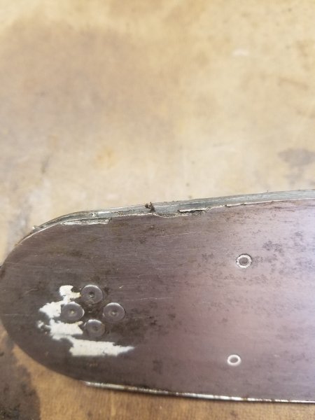

    The new bar got hot? Is the clutch sprocket worn badly and maybe pulling the chain off to one side or the other instead of letting the chain track straight into the bar? Where on the bar was the heat worst? Is the bar gauge the same as the chain? I know, basic question, but I get ahead of myself sometimes...
    I see what you mean on the old bar. Those chunks out are bad pizza. The rivet at the top right of the picture looks like the laminations of the bar are trying to seperate, maybe?

    I see what your saying about the rivet, definitely looks likes attempting to delaminate itself. I didn't get look at the clutch sprocket, ill have to look tonight. Im not sure about the gauge of the chain, its the same one that was on the old bar, ill have to take a look at that too. I dont recall which part of the bar was the hottest. Am I wrong to think it shouldn't burn ya after a minute of running? All i cut was a piece of oak cribbing 2.5 inches tall by 10 inches wide.

    The chunk that is missing at the tip could be caused by either a loose chain or a worn sprocket, both will cause the chain to slap the bar.

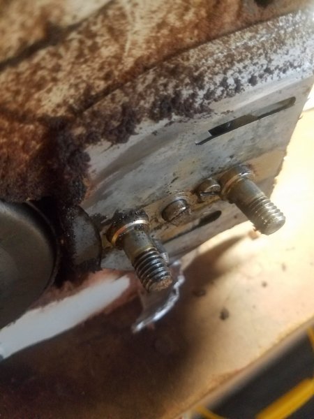

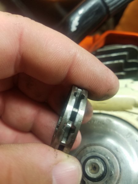

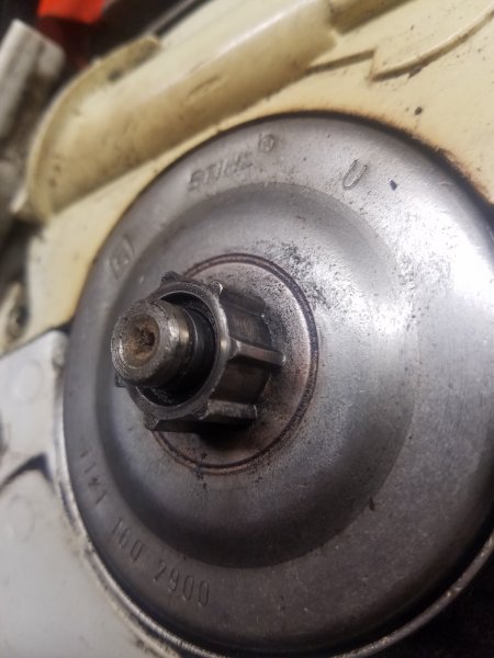

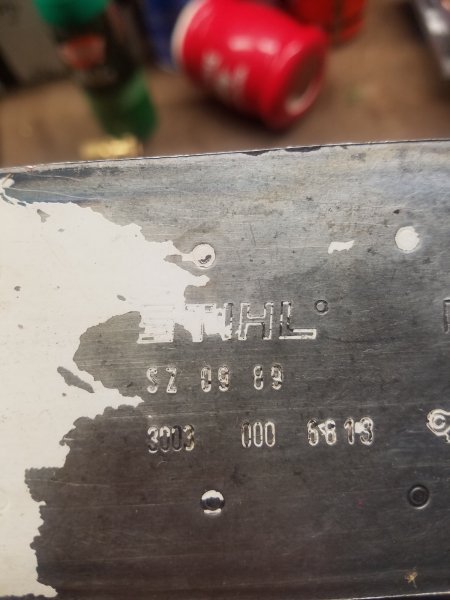

    I did a little investigation tonight on the sprocket and am not sure whats going on. I made six cuts in that oak cribbing and the chain boiled off the water i put on it. Am I correct in mouting the bar on the larger portion of the studs? I did notice the new bar part number was a little different, but have looked to see what the difference is.

    Drape the chain over the nose of the bar while holding it vertical and then pull the chain to see if it is matched to the teeth on the sprocket.
    Then do the same thing with the drive sprocket to see if it matches ok.
    Then set the bar sideways and pull the chain through the bar groove to see if it pulls easy and free.
    Then start the saw with the clutch cover off and give it a small rev and then look and see if you see oil coming out of the small hole where the oiler is.

    So ive done most of that, im not real sure the bar sprocket matches up as well as i think it should. I did run it for a bit and it is oiling. I pulled it through horizontally and it seems fine. Ill try the vertical pull in the morning. Am i correct on mounting the bar on the larger diameter part of the studs? Thanks for the help.

    Yes on Stihls saws they have that shoulder that the bar fits on.
