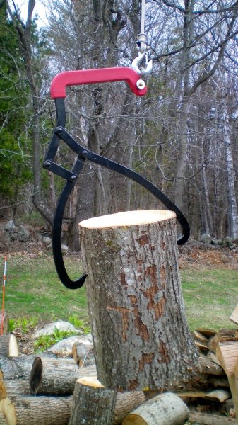

    Nice job on your trailer Dancan... one of your pics shows a set of heavy tongs (can't see if it's lifted by a small boom)... did you build a loader too?

    I put together a simple davit that slid in a stake hole and hung a pulley , I used the logging winch to pull and lift .
    I've had the tongs for a few years , drag them everywhere but haven't tried them yet LOL

    I use a set of tongs with a lift line. Works well...
