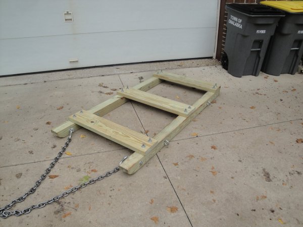

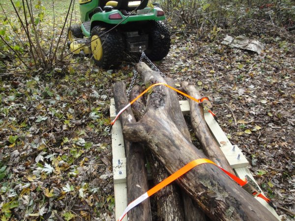

    I think the dray (stone drag in my lexicon) would be the cheapest way to keep your logs out of the dirt.
    Could build a sturdy frame from small logs. Build a skin out of scrounged plastic barrels. It would be nothing more than a large sturdy toboggan.
    Here’s a post with Backwoods Savages dray. For rough ground a skin may be better with a curved front to ride over obstacles. Just my opinion. We had a stone drag that was older than the hills when I was a kid. Two logs and sheet metal underneath. Came with my grandfathers farm. Long gone except for the chain which looks like it was handmade by a blacksmith :)

    Dumf, perhaps one of the best things about the dray like I built is that it is easy to change the construction. I built ours for what we needed. I am still considering building one more but will put bigger runners on it to get it a little higher. Still, what we have has served us very well and it cost around $10.00 to build, which is much easier on the pocketbook.
