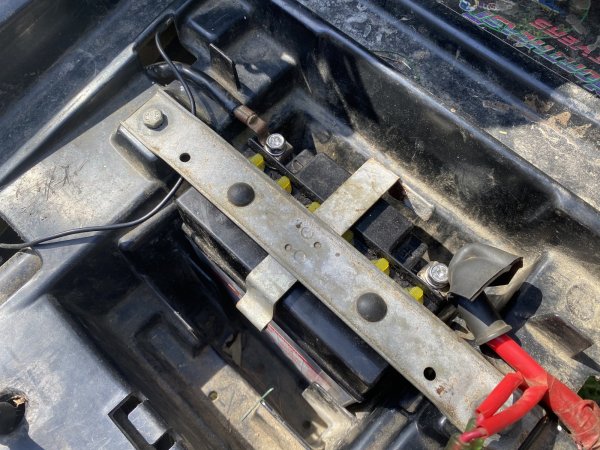

    Can you send pics of the battery cables and terminals? It really sounds like you've got not so great of electrical connections. Maybe try jiggling the cables while hitting the starter?

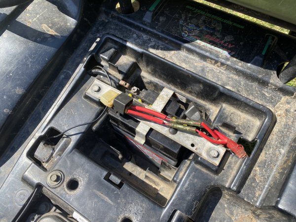

    Check the little bullet connection on the 12ga wire under the seat by the battery. My wolverine is a 2005 and it had a similar problem as you are describing. It was that stupid connector.

    Thanks guys! It’s a 2003. And yes, I now know what wire you are referring to. It’s off the positive wire and it’s the one that’s connected to the inline fuse. I’ll pull that apart and inspect the connectors.

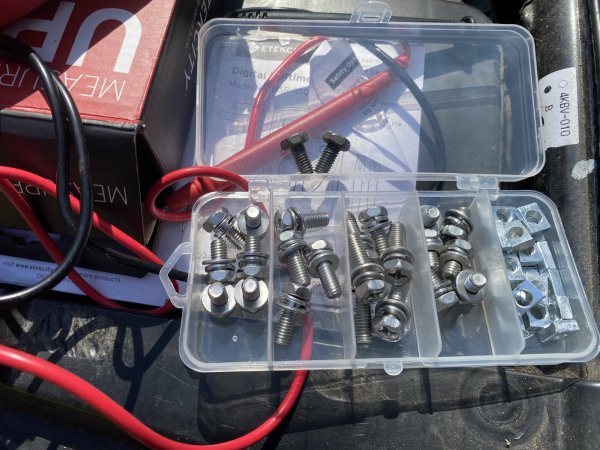

    Good progress today! Started here:
    I jumped that fuse block at the bullet connectors. Nothing. I sanded down the ground wire at the frame, nothing. I pulled apart the switch a the bars, inspected, nothing.
    I then replaced the battery cable bolts with new ones from a kit I picked up from Amazon. Boom; we had lights on the dash and a touch of the start button and she lit right up. So! It was the connection after all.
    Here’s the kit. Money well spent! You can see the old battery bolts in the lid. Wondering if those weren’t the correct bolts for the application all along.
