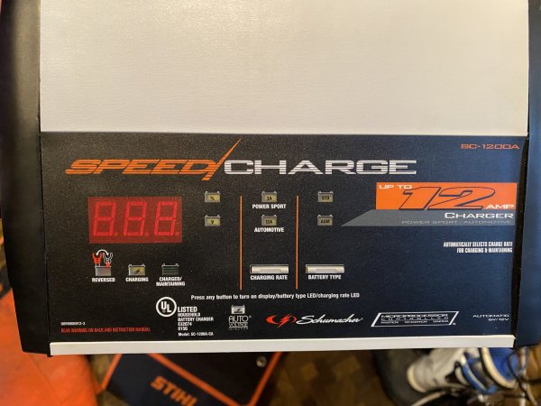

    I’m using a battery charger/maintainer to charge the battery. It’s an electronic unit and I’m selecting standard (vs AGM) for the battery type and power sport (vs automotive) for the battery size. I do have a different charger/maintainer that I could try.

    Here’s a pic of the charger I’m using.

  19. brenndatomu
    25,367
    165,283
    That should work fine.

  20. Skier76
    Skier76
    Dec 27, 2014
    3,111
    17,230
    CT and SoVT
    That charger is what I used to charge the battery Friday night before my failed attempt to use the electric start on Saturday morning.
