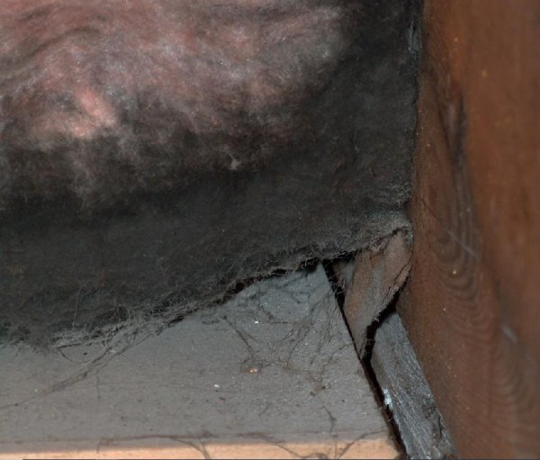

    Attic insulation is a tricky subject. Fiberglass batts can indeed have very high R ratings, however, they are utterly ineffective at sealing air leaks no matter how carefully you place them. Here is a picture of a whopping air leak in my attic....notice how the pink insulation has turned black which is because dust-laden air was moving through the insulation over the years. It was causing frost on the sheathing during the winter, a sure sign of heat loss. You will find air leaks around pipes, wires, sheetrock joints etc. They must be sealed up or they will render R60 batts useless. I shot spay foam on the attic deck to seal all the air leaks and then blew 16" of cellulose on top. The utility bills dropped like a rock.

  2. papadave
    Prime example right there. I had the same issue in the stove room.
    It's fixed now.

    Both are older homes and I would recommend chasing air leaks down first before doing any insulation. The photo above showing the black batt insulation is a great example how it's a critical piece of the puzzle.
