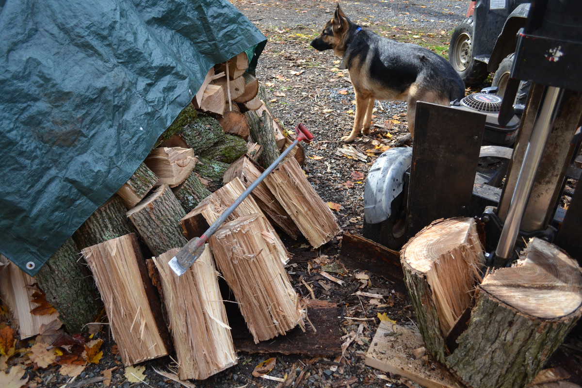

    In the very first picture in the thread the stuff on the left of splitter i read Backwoods Savage say awhile back that splitting around the heartwood works alright and i will see later today if that will be the ticket.
    Plus thinking of putting in a 2x10 behind the stringy crap against the wall of splitter which is kinda like Jeff showed in his picture.
    Gotta try something as i have 4 monsters on the property that would do us at least 2 years but never touched as i know how much of a pain they are.:cheers:
    Horkn and T.Jeff Veal like this.
  18. Loon
    Loon
    6,560
    37,138
    North of the border
    OK, nothing i did seemed to help so i got the angle grinder out and sharpend this small spud bar which so far is the best way of dealing with the strings. :cheers: Its not aggrevating at all. :coffee:
