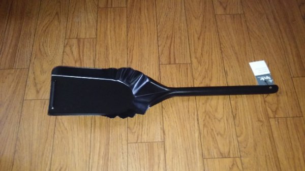

    My thought is to print out a grid for the holes, use a punch to locate the holes on the shovel, and then drill away. My question to the FHC members here that have coal sifters is what size holes should I drill and what spacing for best use. Below is the shovel I picked up at Lowe's Sunday that I will be converting.

    Another option to cutting many holes, would be to just cut several straight lines with a grinder like a cat litter scoop.

    So what's the plan? This scoop will lift the coals up and the ash should sift through. Do you lift the coals and then with a second scoop remove the ash from below?

    Thin sheet metal does not do well with a standard drill bit . You really need to use a punch but having a punch with a throat that deep is not something everyone has access to.
    If you need to drill it a step drill is probably your best bet.

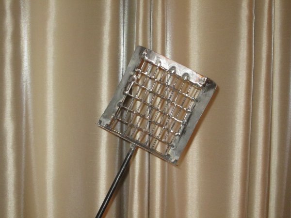

    Made my own.

    Yep I have a home made one too. Used stainless welding rod.
