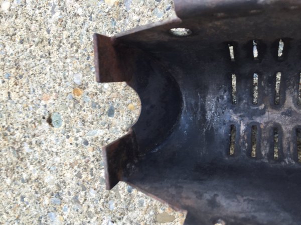

    Hey Eaton, I run 2 burn pot liners (one modified for the exact same reason) pellet spillage. The four "tabs/wings" we're welded on. I think it reduces my spoilage by about 95%. I still get some falling through the curved area below the agitatator bar. Hope this helps someone! image.jpeg image.jpeg

    Drilling small holes has helped me in the area's where the carbon builds. Usually 3/32 is where I start. My liner for the Omega doesn't have as many slots as the M55 liner. I might try an M55 liner the next go round.
    I went the with fingers on the burn grate as to keep pellets in but not restricting the ash falling off/over the edge of the liner. Certainly easier to add the tabs/fingers on the liner than the burn grate. By the time the ash works to the edge, Its pretty fine. I wonder if drilling holes in your tabs/fingers would help ash fall over, Yet keep pellets put??
