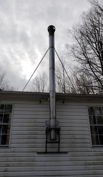

    Here is the photo of the chimney I promised. It probably is a bit short but I can't add on to it without using some sort of lift. I had to get my brother-in-law to add the two top sections on for me. The inlet from the tee to the top of the stove is 16 inches measured from the centre of the tee opening. The roof of the house is very low sloped. It could be the trees are an issue on interfering with the draft. I checked the draft on the chimney a couple of days ago; I had the fire completely out and could touch the top of the stove and the stove pipe with my hands. I removed the stove pipe for cleaning. I tested the draft and a tissue paper at the opening would be sucked in; you had to be at the opening though, away from the opening and the tissue didn't move.
    On a side note, I will need to clean the siding in the spring; the dark stains you see are algae. I hated to take the photo.

    Based on my rough calculations where your Tee comes out; you're below the recommended height of chimney for your stove. You've got a hard 90* on the outside, and even if you have 45* bends on the inside............those 2 bends effective remove at least 3' from the height of your chimney. I'd be willing to bet that with another 3' section of Supervent, your smoke spillage and ash "problem" will be significantly lessened, if not eliminated.

    Yes. I guess I need to see what I can do about increasing the height. Buying the chimney and the roof guy isn't a problem, it is getting it installed. I guess I will live with it this winter but I just don't know how I will get it installed. I am not sure a bucket truck can get into the back garden.

    Would it be possible to loosen the roof bracket clamps then disconnect the pipe at the roof line push the pipe up then slide the new section in. It would probly take two people but that is how I would do it.

    When the stove is in operation, it burns well; I don't have a problem with the operation of the stove. When the stove is cold, I do have to build a small hot fire to get the chimney hot enough to start drafting well and I have the door cracked; I watch the stove pipe temp for an indication of when the stove is ready. However, even with a hot fire; cracking the door and waiting, once the door is fully open, it spills ash and smoke. I might try the draft inducer as a solution since there isn't a problem with the operation of the stove when it is going well. It worked for BDF

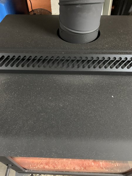

    image.jpg I’ve come to accept some ash flying around!

    I don't think that would be as easy as it sounds. Several sections of this pipe is heavy and there would be no support preventing the whole thing from crashing to the ground. The smart way to do this is to add sections to the top. I will have to look at how to reach the top of the chimney safely.
