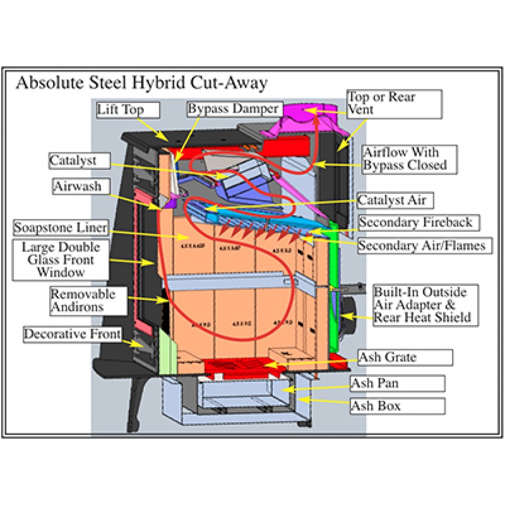

    I was on the lookout for the sound myself today when I got home from work and got the fire going. The sound I'm used to as I described in a previous post about the whoosh/rumble combo gets going on mine when the stove starts to really heat up and get going.
    What I think is happening is as the stove is reaching temperature, the wood begins off gassing more- and the hybrid design of the stove has the secondary burn working in conjunction with the catalytic burn. I don't have a technical grasp on what's happening or the vocabulary to describe it, but what I think is happening is the air is being shot in through the secondary supply and it's becoming really productive and that's the sound you're hearing.
    Check out the diagram of your stove below- I think you're hearing a rush of the air/gasses being combusted.

    Thought you might be interested in our tentative results:
    After many emails, 20-odd pictures, a handful of phone calls, and some welding, the noise has been determined to be: unknown.
    The most interesting possibility we checked off the list was the tertiary air intake on the back of the stove. They have a little pad that sometimes slips off after years of wear. Alas, this wasn't our problem. But, all in all, I did get to know my stove a little better and accidentally fixed an issue with the damper.
    The noise hasn't happened again. I think 4 times in total? Our weather has been unseasonably warm, so we had some time without any burning, and I am significantly less uptight about the whole thing. Woodstock is still mulling this issue over and if it does happen again, I'll be trying to record the noise so they can hear it second-hand, at least. For now, they don't think it's a hazard, as the stove still seems to be operating well and there isn't any obvious damage occurring anywhere.
    Per the hypothesis from RGrant about the stove being really productive-- I did mention it in one of my phone calls with Woodstock. They seemed to think it was "possible, but not common" enough for them to confirm that's what's going on with my stove.
    Thanks for the help everyone. If I ever have a proof-positive answer on this noise I'll make sure to update this thread.
