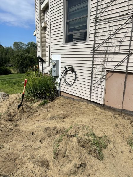

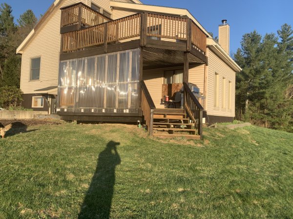

  9. Canadian border VT
    19,836
    132,351
    Mines outside I think it’s 26’, IIRC you can’t use single wall outside. I also have interior chimney 2x4 brick going up central part of house
    cleanout exterior 4 foot high left of electrical panel
    Back roof brick chimney edit that’s 5 years ago before my projectss:emb:
