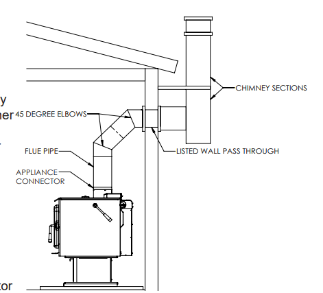

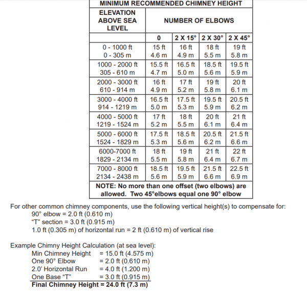

    Hoarders we're looking at a wood stove and recommended pipe height is 29.5'. That won't work here, would be 15' sticking up in the air above the ridgeline of my ranch home, until the first gust comes along that is.

    What elevation?
    How many elbows you need? 45's or 90*?
    T.Jeff Veal and wildwest like this.
  8. wildwest
    30,792
    145,542
    7-8K elevation
    2 45's (looks like the 22.5' accounts for them)
    one 2' horizontal run
    one T
    is where I got 29.5' from.

    Pretty much exactly this:

    At 1000', like we are here, I'd say a 18-20' chimney of that configuration would be fine on most stoves, but at 7.8k I'm not sure what it'd take...are you still looking at a BK, or considering a WS now?

    I talked to Dealers installer. He said "Rule of thumb around here is 18' " Great!

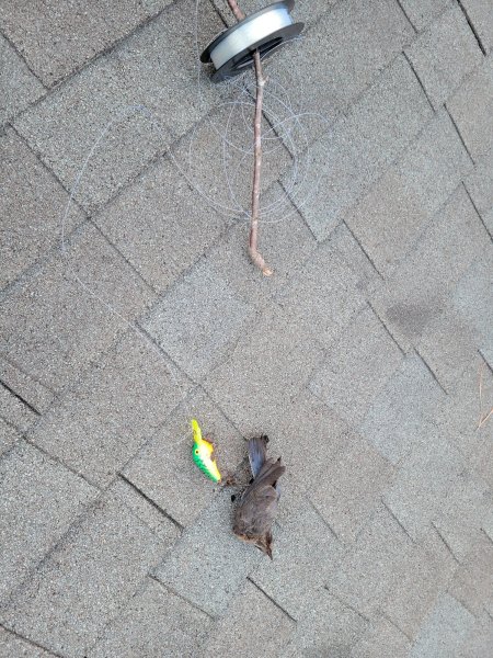

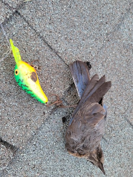

    Actually glad I have a short pipe for now. I meant to post a thread on this last week, but forgot. Went fishing in my chimney
    .....look what I caught!
