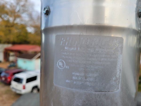

    Got up in the roof today, tag on pipe is a bit hard to read but looks like rhino rigid...

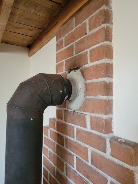

    If I get the DVL pipe linked above...how do I connect it to the thimble piece (think I'm using the correct term) shown in the pic? I guess that piece is rhino rigid, since that's what the tag on the top chimney piece says. On northline's site, the chimney adapter piece says it connects to duratech, duraliner etc pieces...so I guess it will only attach to other double wall? Or do they just say that and it can work with other pipe? Is there another piece I should be looking at to connect the 45 (hopefully, if room allows for 2 45's vs a 90) to the thimble piece?

    Not sure how the 45s will affect horizontal distance to the connection, coupled with rear clearance etc. Planning on a 12" and adjustable 2"-12" up to two 45s, and needing an adapter for rhino rigid liner connection. Question is, can I use an adjustable piece (a 2"-12") for horizontal if I need to?

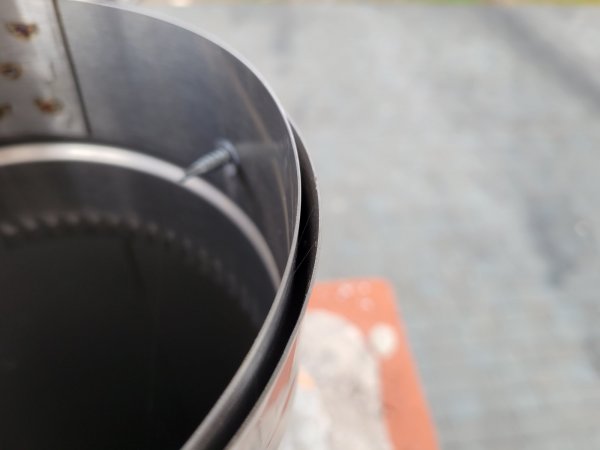

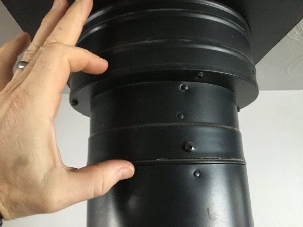

    That adapter is made to be screwed onto a duravent ceiling support box when you are using dvl to the stove. I have one on my chimney. Attached a photo.
    Seems like you just need to fit the stub of the liner inside some part of a DVL system and be able to use screws to hold it. Be prepared to add crimps to the rhino stub with a crimper to reduce the diameter if needed.

    I’m pretty sure you can shove the dvl 45 right over a properly crimped rhino stub and run the screws through the outer and inner wall of the dvl into the rhino.
    Don’t boof the rhino stub. It’s probably pretty hard to replace.
