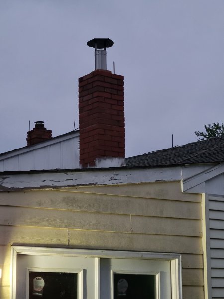

    I will measure my chimney down to the T, have been meaning to but time hasn't worked out lately. When we bought the house, the liner was cracked, so I had a chimney guy come and fix it. They put in metal, and poured some kind of concrete (I guess that's what it is/was) around it. There is a piece of single walled metal pipe sticking up out of the brick chimney..I think I have a pic to post, if not I will post one this evening. Not sure if I need to "do anything" with that piece of single that's exposed (for temperature /condensing reasons)?

    The single wall piece that's exposed is fairly short, so don't know if there's any issues...

  8. Canadian border VT
    19,836
    132,351
    I doubt this is single wall. I would bet it is Class A. If for no reason other than the color

    I'm fairly certain it's single from when I've been up there before, but when I measure I will take a pic.

    I would tend to agree...looks like single wall to me...

    Got on the roof. Left phone in vehicle and it was last light, but pretty sure it's single. There was a faded sticker that I will go back up there to see what it says. From tip top of pipe (not rain cover) down to take stopped in bottom of T (or 90 I guess) is 10 feet 7 inches. Will measure from the T down to approx stove top later...

    If I can get back on the roof in time tomorrow, I'll take a pic of that top piece of pipe, to see if anyone thinks I need to do something to it, or any recommendations.

    Floor of fire box to top of chimney, your total chimney height.
    Your chimney is on the short side like mine. Some of the advice you’ve received will off-set being short. I would use every piece of advice you get to help combat being short.
    If possible at all, move stove away from wall slightly, or more, to accommodate the 2-45* advice.
    Double wall stove pipe mentioned with stainless interior. Your new WS stove will throw plenty of heat into the home for you, and will do it better with double wall stove pipe and it will last. I just bought single wall and I am kicking myself. Go double wall stove pipe. It too will off-set being short.
    Insulate that top section somehow, to the top, if it isn’t already class A double wall.
