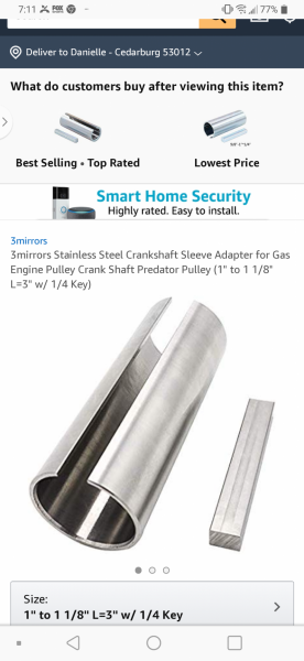

    Ok. Long story short, the magnum 18 has a 1" shaft. The kt17 in the ariens is 1-1/8".
    Length looks too be the same, although the clutch is being stubborn on the ariens and we have it soaking overnight with penetrating oil.
    So, how would you guys deal with this?
    I haven't looked on McMaster Carr yet, but maybe they have a shaft adapter?
    Outside of the shaft size, it looks like it should all be a simple swap. I'll post up pictures later...

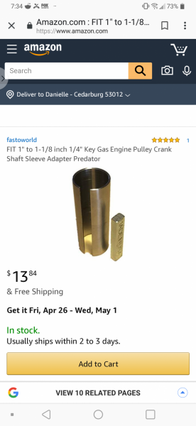

    How about this?
    It's really 3.5" on both Shafts but that should be fine. Screenshot_2019-04-20-19-11-50.png

  5. brenndatomu
    25,351
    165,113
    Yup, that's what I would do with it ^ ^ ^

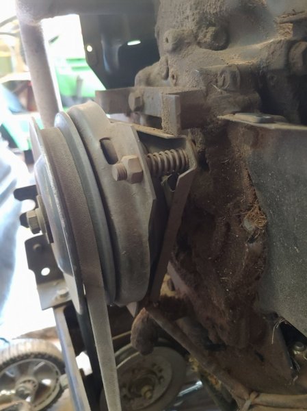

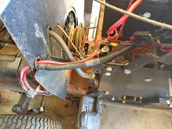

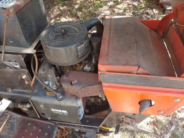

    Magnum 18 in the craftsman
    Kt17 in the ariens

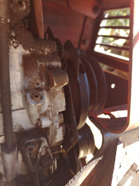

    M18. There's a single pulley on the craftsman so I can't use this clutch in the ariens.
    Ariens
    Airens . The
    clutch is being stubborn.
    Above..the m18 is pretty clean.
    Below, the ariens, and the stubborn clutch.
    Marvin, Hammy, Screwloose and 2 others like this.

  13. Horkn
    29,268
    167,118
    So I'm about to order the shaft adapter. I can go with the zinc steel one, or the stainless steel one. I want to go with the SS one, just a little worried about dissimilar metals "welding" together. I'll use a load of anti seize at any rate.
    So, would you guys get the SS one? It's like $4 more
    Hammy and Screwloose like this.
  14. brenndatomu
    25,351
    165,113
    I use a ton of stainless at work...never seize it and you are golden...but you could be fine with never seize on steel too. Just don't slobber it on too thick and end up with it in the clutch or on the belt...this is one of those less is more situations...
    Hammy, Screwloose and Horkn like this.

  16. Screwloose
    Screwloose
    Jan 15, 2017
    5,717
    33,953
    I'd say get the stainless one although either one is fine. Never seize is your friend.
