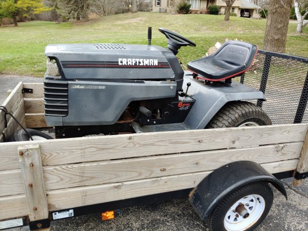

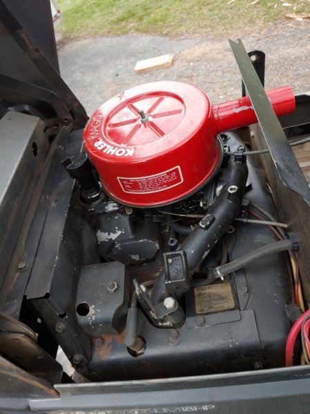

    There were a few in Michigan as well. No need though, I got the one in northern Illinois. $200 it runs great. Doesn't smoke, and while the rest of the tractor is a bit rough, the motor is very clean.
    I read somewhere on the internet that this engine has the same exact output shaft as my GT17. Let's hope so as that will make this swap really easy

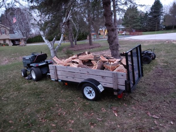

    Well, I put the crapsman to work, to really test how well it runs.
    The battery is dead, as in doesn't take a charge well, but it jump starts. I've got it on the charger,v but I have nearly no confidence that it will take a charge as it could barely turn the engine over, literally right after I parked it after running it for 40 minutes or so.
    I loaded up the green honey locust that I snagged a few weeks ago and split. I moved it to my piles down in the lower part of the yard. 20190413_194539.jpg
    No issues. I did notice that the throttle cable isn't adjusted correctly and it doesn't go into full rpm unless I move the throttle at the carb. That's not a big deal as I'm sure I won't use that cable on the ariens.
