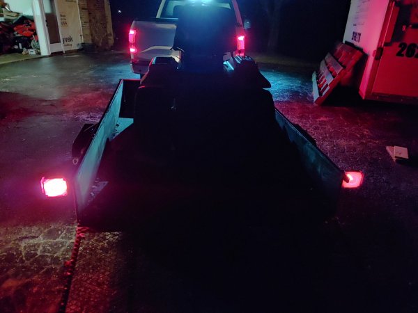

    Tractor is on the neighbor's 5x8 trailer. The extra foot allows me to leave the deck on the tractor.
    I used the Bayou to push the tractor onto the trailer. My neighbor helped with steering the tractor and he put wood splits behind the tires so it couldn't roll back. 20190407_204358_HDR.jpg
    I'll take it in to the city where I work where we can work on it.
