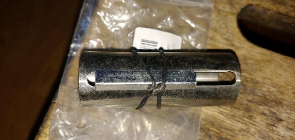

    I had to modify the spacer.
    See the difference? I had to cut the one end to be an open slot, plus there were decent sized burrs on the inside of the spacer that came from the machining. I fixed both with the Dremel.
    So, more anti sieze.... And..
    Success with the clutch!!
    Notice the hickory persuader?
    It didn't need the persuader to fit on when I used the second adapter. The first one was undersized on the ID. It wouldn't go on. The second one, once I opened the slot and deburred it, it fit perfectly. The clutch went on with nearly no effort.

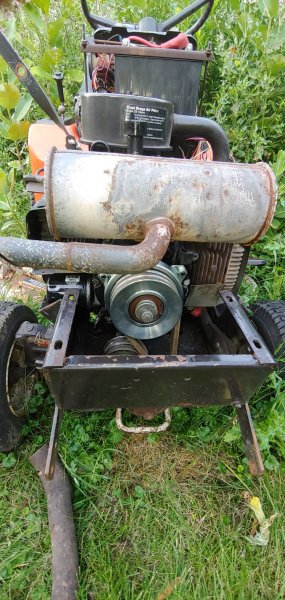

    It mows. But now I need to replace the bearings on the spindles, or just the spindles and new blades. Getting there. However, we didn't put any rtv or other sealant on the flywheel seal. Well... It leaks. Grrr
    So we have to take the engine out again probably because you can't get to the flywheel without taking the engine shrouds off. Those are not really able to be removed without taking the engine out. Ugg. So the whole engine might need to come out again. We are good at doing the engine r&r though, unfortunately.

    So you modified what you had, or got a different one?
    If you modified it...nice solve! :yes:

    Modified the second spacer I got. The first one, the SS one was oversized. The second one I had to cut the "bridge" off so I could slide the sleeve over the key. At least the second one was machined correctly.:loco: :crazy:

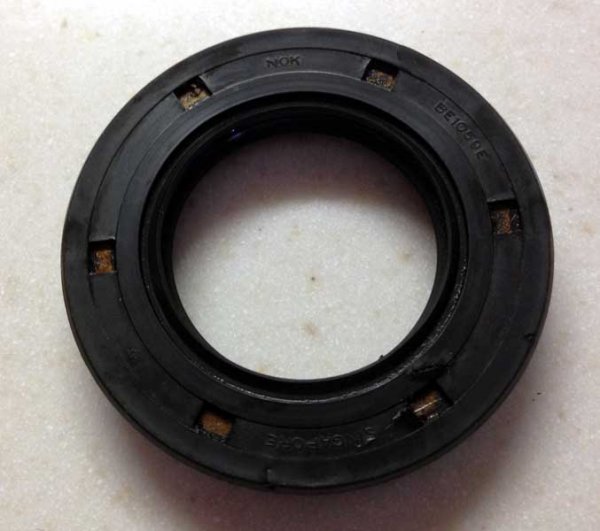

    But the manual says seal it. So that's what it needs. We burnished the clutch in per recommendation. It works well, just need to do some odds and ends on the tractor.

    So getting back to this project....

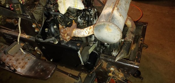

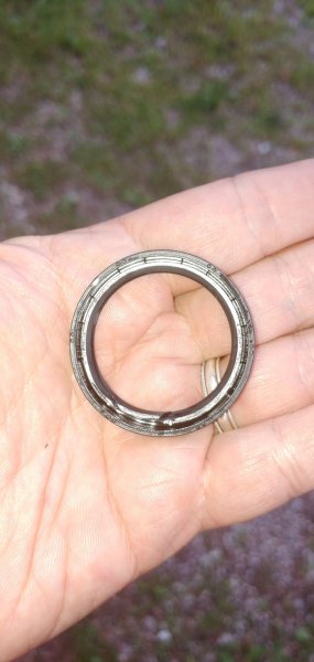

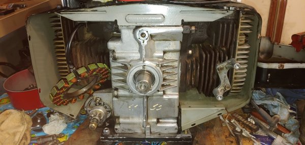

    We pulled the engine to see the seal that had to have failed.
    We pulled the engine out in pretty good time. Practice makes perfect, lol.

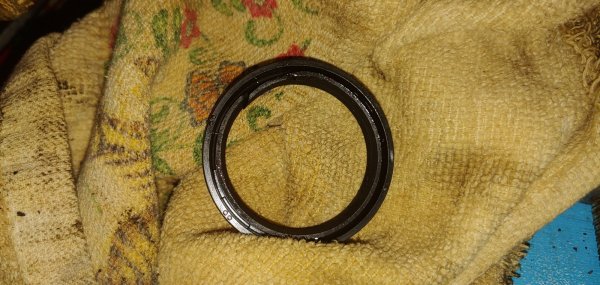

    The seal had to have gotten boogered upon install. That's what we think. But surely we would have seen that right? The lip was out on the inside toward the flywheel stub.
    Here's the seal. It was new when we installed it, and it ran maybe 8-10 minutes. It spewed oil all over, chit around by the flywheel blowing the air around.
    Here's the engine after using some brake clean to get rid of the oil film.
    So what are your thoughts on the seal failure?

  10. brenndatomu
    25,353
    165,137
    I'd agree...and you'd think it would have been noticeable, but maybe not...dunno...bet it gets hawkeyed this time! ;)

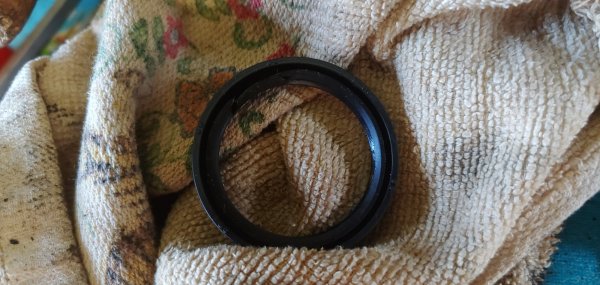

  11. Horkn
    29,268
    167,122
    You can't tell as much from these pictures, but it's all the same seal we pulled.

  12. brenndatomu
    25,353
    165,137
    It was still in place when you took it apart? After blowing that last pic up it looks like something cut it, from the outside...almost like something punched it...
    Screwloose and Horkn like this.
  13. brenndatomu
    25,353
    165,137
    Wait a minute...that's a single lip seal...was it mounted lip out, or in?
  14. Horkn
    29,268
    167,122
    Yes, it was in place, just the inner lip that is cut was protruding like it was pushed out from the inside.
    It was put in the same way as the old one was put in. I think...
    Now you have me thinking..
    Screwloose and brenndatomu like this.
  15. Horkn
    29,268
    167,122
    No, it was installed the right way metal tension spring in toward the oil side/inside the crank.

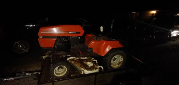

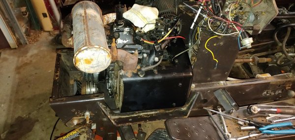

    Ok, back to it.
    My buddy and I put the oil seal in tonight. We quadruple checked that it was going in properly. We also set it on a little deeper than the last one. We used the sealant and then rtv on the outside, despite the old seal not blowing out it's possible that the lip on the crank caught the seal lip and messed it up on the last one. By setting it a tad deeper, there should be no issues. Both of us eyed it up and around all 360 degrees separately and we both signed off on it. The grey rtv and gasket sealant should only ensure its good. There's still a good bit on the oil return galley, so the seal isn't in too far.
    Then we got the engine reinstalled into the chassis. The driveshaft was easy to install, and the bolts lined up pretty easily for the engine to the frame.
    Again, after you do something a few times, you get good at it.
    The sealant and rtv have to set up, so we'll get back to it on Wednesday night. I'll bring the mower deck and the neighbor's 5' wide trailer so we can hook up the deck, and drive it on the trailer, so no more messing around.

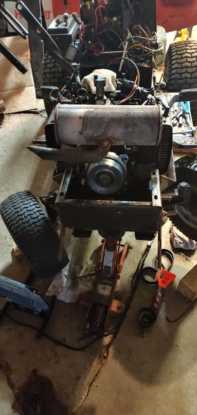

    Here it is now. Just need to put the belts on the PTO pulleys, hook up choke, throttle and a couple electrical connections, plop the hood on and it should be good. I'll need to get the headlights hooked up, but that's minor.
    Maybe I'll bring the different seat out on Wednesday so that could be mounted. The seat that is on it is not in great shape and lets water into the foam. It may be as easy as drilling a couple of holes or welding nuts onto the seat bottom. Or something. We've got a grinder, drills, and a welder. And duct tape. Lol.

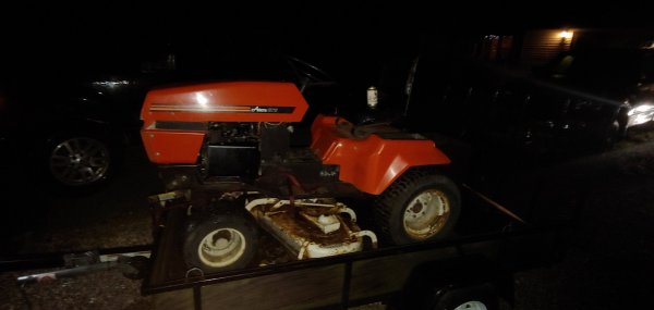

  17. Horkn
    29,268
    167,122
    Done. It's all good. We mounted the deck hooked up all the electrical connections, hooked up the choke and throttle cables.
    We changed the oil, and mounted the different seat that my dad had wanted to put on the tractor years ago. We had to drill 4 holes in the seat pan, but it was pretty straight forward once we started working on the seat m. The original seat was pretty bad, allowing water to get into the foam due to all the cracks in the vinyl.
    I'll get better pictures tomorrow. She still needs a few things, including a good wash, the key switch from the craftsman won't fit into the hole in the dash. It's odd, but it won't go. The original key switch started acting up, and doesn't work.
