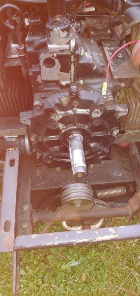

    Clutch and new gas cap are here today. I installed one of the two items in a minute. 20190610_175716_HDR.jpg
    I'll work on the clutch tomorrow. I'll need to find some 1-1/8" bushings. The local fleet farm has 1" or 1-1/4", but not 1-1/8". I could see if maybe northern tool or some other local place has these instead of having to buy them on Amazon or elsewhere. I don't know how much bushings / spacers I need. I'll know that as soon as I put the clutch on and get the belts on. The belts should self align it. The crapsman had about 1" length of 2 total bushings.

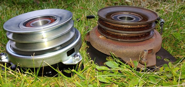

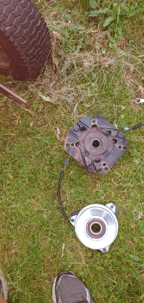

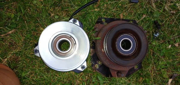

    New and old clutch side by side.
    Burnt ends. They don't smell good though.
    The new one is possibly a tad shorter. Shouldn't be an issue.
    Test fit , the bushing didn't want to fit in. I didn't want to try too hard without gloves. That thing is sharp. 20190611_192715_HDR.jpg

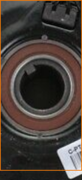

    But it does show it fits. Now the new clutch has a key built into it. The only issue with that is that the key is "short" . If you get what I mean.
    I hope that won't be an issue.

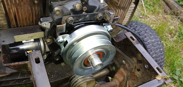

    Side angle. It has enough room to get the belts lined up. 20190611_192721_HDR.jpg
    The bracket at the top on the clutch is the "anti rotation" bracket from the crapsman.
    I took it off, and tried to get the clutch on over the sleeve. 20190611_192721_HDR.jpg
    It looks once I get this buttoned up, that it should work, right?

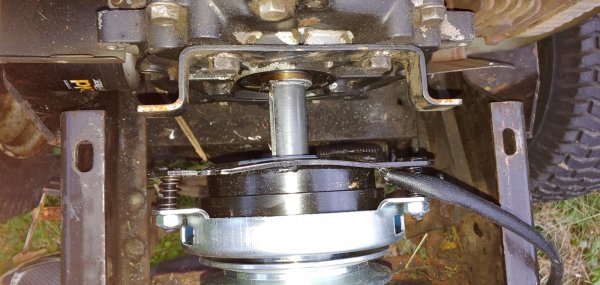

    This is as far as I could get it by trying to put the spacer on first. I think I'd rather try it the first way, and maybe just use a longer bolt to cinch the spacer in by pushing it in with the use of a washer.
    I was running out of daylight and the skeeters were getting bad by the garden area.
    Enough for today.
    Here's the gap because of the step down bushing.

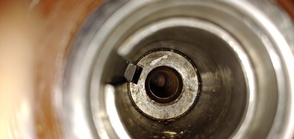

    That key is gonna be a no flyer...you say its built in...I doubt it, that would be very abnormal...it is probably just a very tight fit. You will need to get the right key in there...
    Hammy, Screwloose and Horkn like this.

    Let's see.. I don't have a good picture now of that key. Here's a close up of the eBay picture
    I'll have to get a picture with my phone where I can zoom in.

    A lot of split taper bushings have a built in key. With today's steel casting abilities a lot of once impossible crap is now possible.
    Hammy, brenndatomu and Horkn like this.

    It's raining here, otherwise i'd get that clutch off to get a better picture of the key on the clutch.
