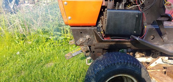

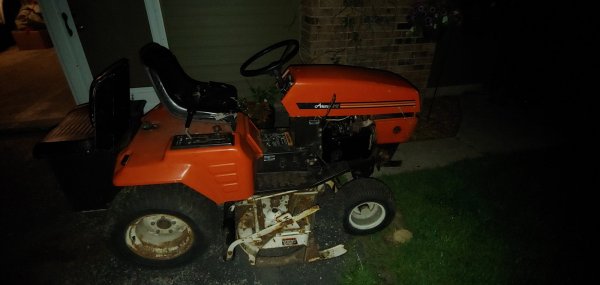

    Got my GT17 repowered with the magnum 18, and upon trying to use the mower, the clutch starts to get hot, then it robs power, then it will reduce the rpm to barely running. We adjusted the gap on the clutch, and it still does this. The clutch seems to engage with no issues. The epoxy on the coil for the clutch is cracked. However the epoxy was cracked when it ran last before the old engine broke a rod. So it's this fixable, or do I need a new clutch? Looking around I see a couple with the double pulleys, for new ones.
    I'll try pulling the PTO shaft to the mower and seeing if it still smokes that way. It's possible that we didn't put the clutch back together right, but not probable.

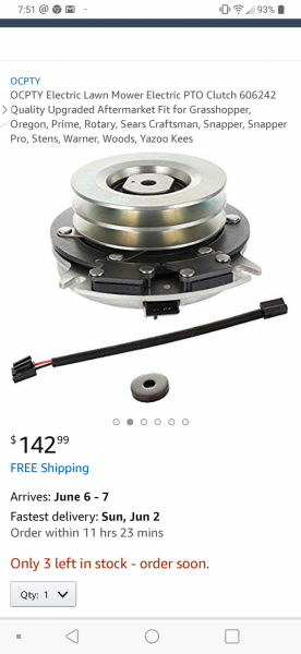

    Looking around I see a few with the double pulleys on Amazon. They are harder to find. And have a little different mount, but this one I found is from a simplicity sunstar, and that had a Kohler magnum in it so while the mounting bolts are a tad different, all they have to do it keep the clutch from spinning, and the bore has to fit into the output shaft. Right? Screenshot_2019-05-31-07-51-06.png

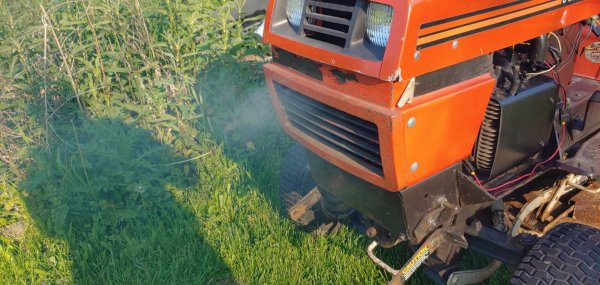

    Well... It smoked alright.
    I took off the driveshaft for the PTO to the deck and tried it. Smoke show with some sparks.
    I then saw plastic melt from the epoxy around the electromagnet. 20190602_175807.jpg 20190602_175917_Burst15.jpg
    So, yeah. I need a new clutch. The ariens exact replacement is $700. So that's not happening.
    Digging in the Google wormhole, I found this..
    It's a pretty standard warner replacement clutch. warner: 5215-62. There's tons of these, and quite a few with 2 pulleys. I've found a few for ~$100 that have 1-2 yr warranties.
    This warner part # is really just a way to not use the proprietary ariens part, which is expensive.
    Essentially this will mount just like the clutch that was on the craftsman donor tractor I bought, but the proper 1-1/8" bore and the 2 pulleys. I just need to verify the pulley size on the ariens, I think it is 5" diameter. The clutch is cool now, so I'll measure. I'll need to buy some 1-1/8" spacers to keep the pieces inline, although the 2 belts should keep it in line.
