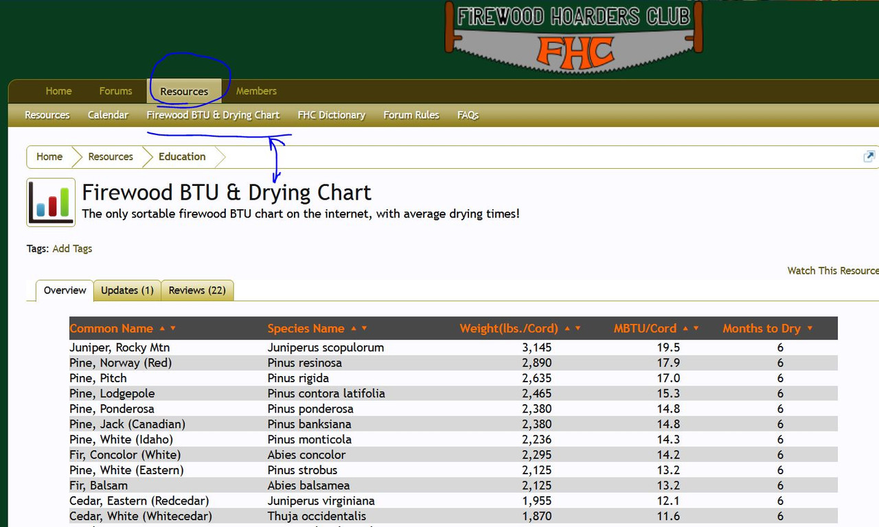

    Uh, we could each beat this to death one specie at a time or we could use the chart.
    We have a chart?
    Yes we have a chart.
    HERE IS THE LINK to the chart
    Here is what it looks like:
    Husky Man, Horkn, TurboDiesel and 5 others like this.

    I think this chart has some questionable data on it...don't recall what exactly, but I know its reliability has been discussed more than once...
