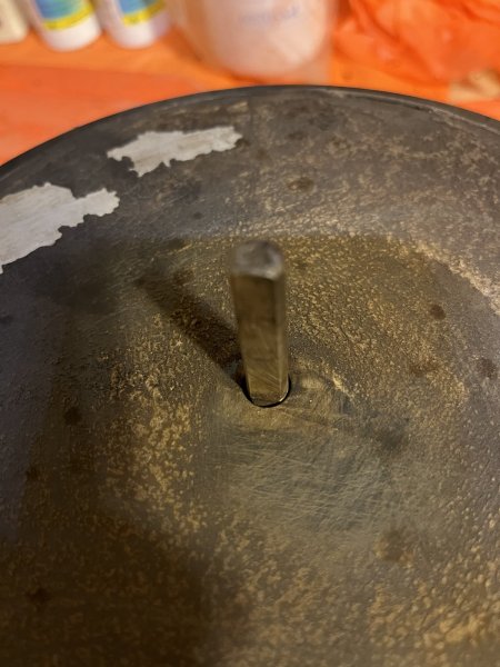

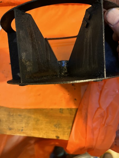

    So I just got ready to go to bed & my wife closed the shade in our bedroom window & said” honey the red light is flashing on the wood stove “ so I went over & sure enough the fan breaker was tripped. So I figured I may as well take the blower motor off & see what I find. image.jpg

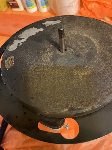

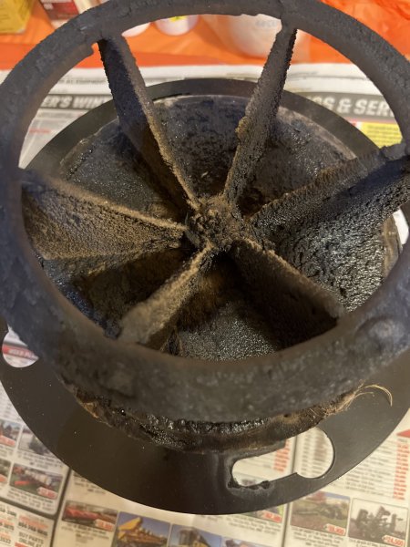

    Any ideas on the best way to remove this crud? Wire brush?
    brenndatomu likes this.
  6. brenndatomu
    25,352
    165,129
    That would be my first choice I think...that and a putty knife, or some sort of scraper.
    Might could carefully apply some heat to it to get things dried out and easier to remove...creosote will kinda puff up when heated up...easier to remove then. Looks like maybe it just needs cleaned up all around the edge there...where the impellor is almost touching the fan housing...or is the buildup hitting somewhere inside the housing when mounted up in normal operation?

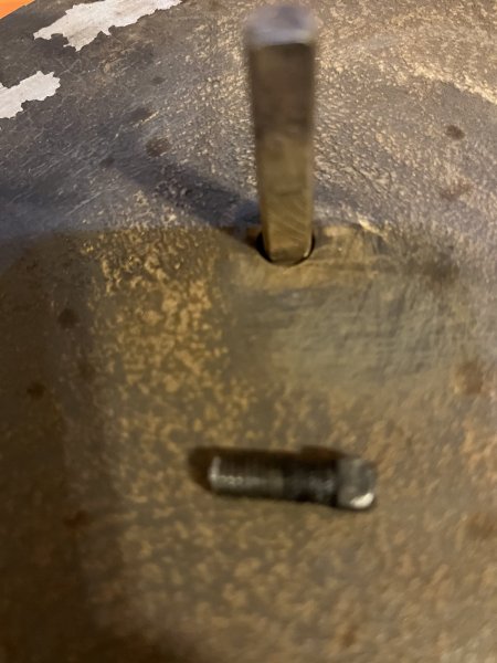

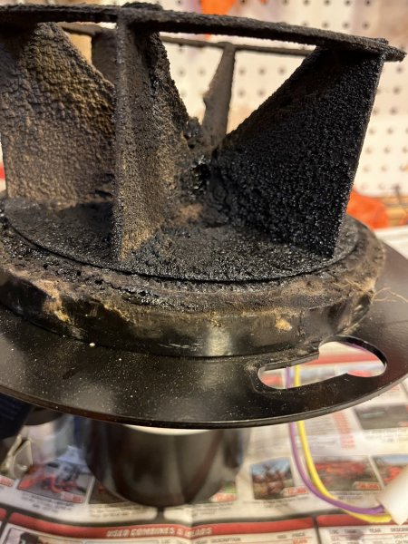

    I got the impeller off. And scraped all around the motor side in the back of the impeller. It’s all pretty crudded up but it’s dry creosote. A lot is coming off the brush I just sprayed some WD-40 on the spot to see if that loosens it.

  8. brenndatomu
    25,352
    165,129
    I'm surprised that it's that crudded up...my understanding is that things usually dry out/clean up when it gets cold (like its been the last day or so) out and the boiler gets a chance to stretch its legs a lil...

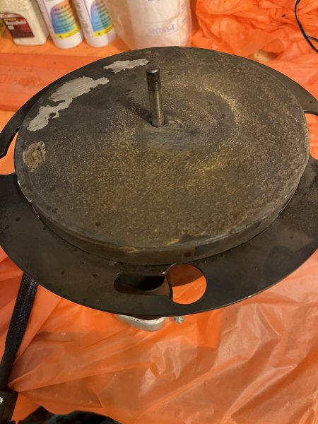

    Got it back together & it’s running. We’ll see what we have in the morning.

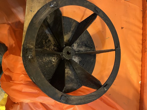

    Somewhat cleaner: 63EAEA2B-D8AD-4086-8D9F-5AB71787AA3D.jpeg 4382C4E4-1371-4A13-86F4-C4DC17647ADD.jpeg 9D840D03-62E6-4840-B2D9-93980D75E5C6.jpeg CCE5CA0C-A65E-4CBB-9BEA-A1C42A620A58.jpeg 7C39CF85-5442-4F3E-AA38-C2DA4C2F52A4.jpeg 91BAA8F5-32F8-4EB7-A276-61DC3AA2AB49.jpeg

    I've had that happen to me before with the fan, what sucks about mine is that it has glass fuses instead of circuit breakers
    Its usually after a bit of a warm spell, and the boiler ends up idling more
    Nice thing is that it comes out easy
    I've used a hacksaw blade to clean between the impeller and the housing

  14. lukem
    12,329
    67,050
    Looks like the impeller most likely got stuck by the looks of that build up. I get some buildup of dry powdery ash on mine that I clean off once a year.
    Only had the creosote problem once during some mild weather when I was burning wood that wasn't nearly dry enough.
  15. morningwood
    morningwood Administrator
    Oct 17, 2022
    445
    2,138
    This was / is a problem on the older G series. On the boilers we have you can only have the bypass lever for a maximum of 5 minutes and then the fan kicks off. I took my fan off a month or so ago, it had a layer of fine ash on it. The HM gurus recommend cleaning it at least once a winter and at the end of the year. My plan is clean mine as often as I can since it's not a very hard job.
    I took the plate off of the back and vacuumed out above the turbulators too. That was probably a waste of time but I figured I'd do it while I had the tools out there.

    I was surprised that the material on the impellers was enough to keep the fan from turning.
