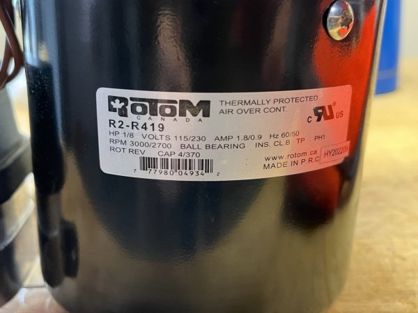

    I know they had a problems with fans getting cooked on the original G series because people were leaving the bypass open too long and cooking the bearings.
    Haven’t heard of any fan issues on the new G series. I need to get a spare fan motor myself for my boiler and furnace. Cleaned mine a month or so ago. Searched for one on the internet and they seem to be readily available. Pic attached in case you need the info.
    Couple people on Facebook have had a very similar scenario and it’s the same scenario as lukem mentioned.

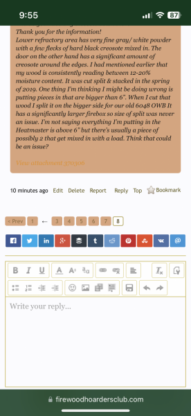

    Know you said your turbulators move without any problems. What’s the color of you lower refractory area ? And do you have any creosote down there.

    The bottom of your stove is exactly what I’m seeing with mine also. I have a touch of creosote on the hinge side of the firebox by the door. Been there since day two.
    The experts say, you should only burn stuff that you are able to pick it up with one hand. I’ve burned some pretty big pieces in mine but I’ve always mixed them in with split pieces, they’ve burned fine. That’s what I do with wood that I suspect is a little wet too. Most of my wood tests around 20% moisture on a fresh split face.
    Do you have a good deep coal bed ?
    brenndatomu and Farmchuck like this.
  18. Farmchuck
    Farmchuck
    Dec 18, 2016
    1,790
    8,790
    Nepa
    Yes. A nice bed of coals for sure.
    Glad to hear I’m not alone.
