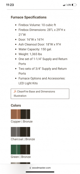

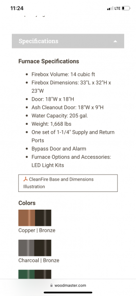

    55ECE0DB-AA37-4B50-BE56-A6ABFF287284.png DD5E9EB8-10F9-4462-B298-BCA6D15827FC.png
    the other specs on the 300 and 500
    Farmchuck likes this.

    So we will use the 91,502 BTU/gall for propane, but 800 gallons instead of 1000...x .84 = 61,489,344 BTU's used by the house (and/or appliances) so you would have to decide how much of that is used per day, week, or month, but I'm just going to spread the total over 6 months/180 days evenly, just for a rough example of the heat you need. 61,489,344 over 180 days is 341,607.47 BTU's/day or 14,233.65/hour.
    The garage is using about 400 gall/yr (?) that math would be 91,502 BTU/gall x 400 =36,600,800 BTU's...x .83 (% effciency) =30,378,664. Over 180 days that's 168,770.36 BTU's/day used by the garage...or 7,032/hr.
    So if your heat load was constant over 6 months you'd need a total of 21,265 BTU's per hour to heat both buildings. They claim the Cleanfire 300 is capable of a max of 66,894/hr x 8 hours (3 times/day loading) so the 300 would be more than enough to do the job IMO...feel free to double check my math/calculations. Oh, and keep in mind any LP used by other appliances is added into your heat load too...probably minimal though, other than maybe the DHW, but that could be tied into the OWB too. Like I said earlier, bigger (oversized) is not better when it comes to gassers...
