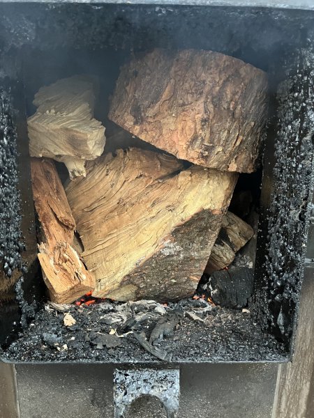

    I took a before and after pic of loading this afternoon. Didn’t rake any ashes and filled it up with my usual ugly chunks of all shapes and sizes. Closed the door and done. Not saying this to brag, just showing that nothing special is needed for my unit.

    How are pieces that are large gassing enough for your boiler to function properly ? The more surface area you have for the wood to be charred on the more wood gas you make.

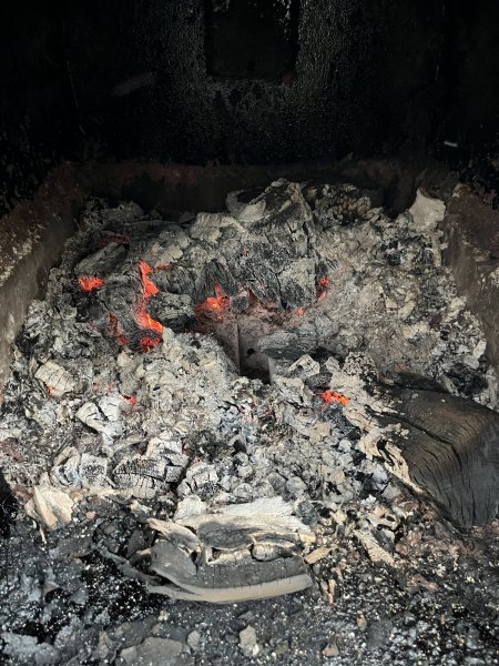

  6. jrider
    jrider
    Feb 12, 2018
    6,101
    43,040
    Just a picture I took this morning before loading it. Thats what was left from the previous picture I posted
    Barcroftb, Farmchuck and brenndatomu like this.

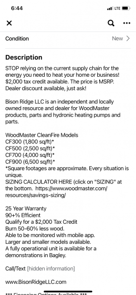

    Well the smallest wood master is the clean fire 300
    That they rate at 150000 btu boiler is 11,000. Next one up is the clean fire 500 at 200,000 btu hours. The 500 is about 3000$ more and I’m sure one of these 2 will heat what I need. 2300 sq ft house with 2x6 walls and 24” of fiberglass in attic and a 900 sq ft shop insulated 2x4 walls all the way around and 12-16” fiberglass in ceiling. The shop is basically half the whole garage with 10 ft walls and a flat insulated roof built inside the main peaked roof of metal garage

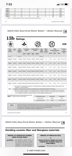

    It’s a propane boiler in house Weil McLain CGA gold so the older less efficient style boiler. Go through 2 500 gallon tanks a year roughly. Garage is a forced air 45,000 btu heater 2 250 gallon tanks a year there usually.

    I have the cga 3 or 4 pretty sure it’s the 4

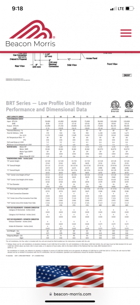

    Is that a hanging "unit heater"? (typical garage heater) probably 80% efficient if so...need the efficiency rating to calculate BTU's "used" by the building...

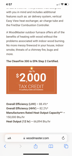

    When looking at the ratings make sure you make your buying decision on size is based off of the steady state BTU's / 8 hour burn rate the boiler provides. A G4000 can max out at around 100k but the steady state is 68k. My toaster bank on my geo is 55k BTU so I knew I'd be good with the boiler that provided the 68k steady state.
    This is for temps <10F or 0F in my case.

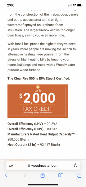

  19. Lehman
    Lehman
    Dec 21, 2021
    616
    2,047
    Minnesota
    33B4CF47-AF25-4E34-AD12-CA2F6C052457.png CDE048E0-77A1-4F37-83D0-0CA2DD68183F.png
    the clean burn 300 & 500 ratings
    brenndatomu and Farmchuck like this.
