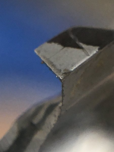

    After sharpening, do you run your finger against each tooth to feel it's actual sharpness? It should "catch" your finger and feel similar to a very sharp knife. Here a close up of some damage. When that happens, you have to file off enough metal to make any signs of that damage disappear.
    That pic^, the working corner (most important part) is dinged. It needed filed back to remove all that damage.

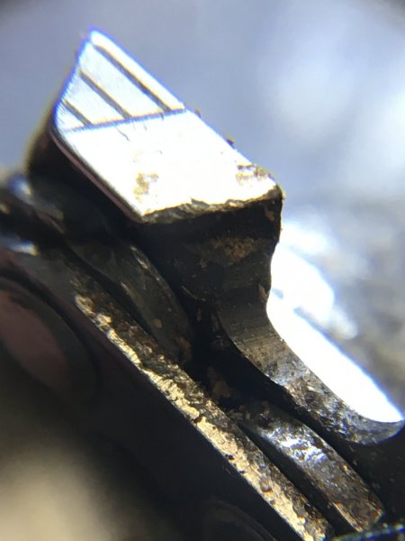

    Might not help round filers as much but here's another showing damage. A couple swipes with a file just won't do in this situation. You have to make sure you file back and remove all that damage.

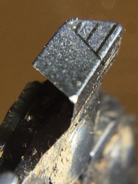

    And the nice crisp straight fresh edge.
