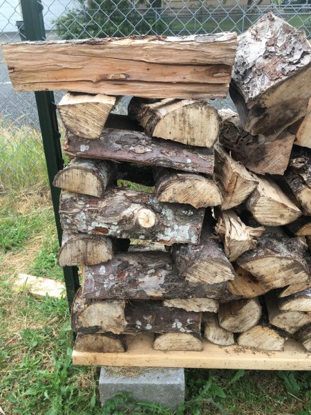

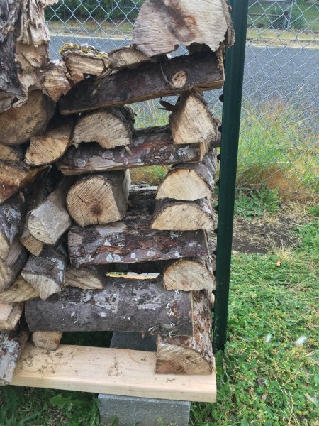

    Backwoods Savage, so I cribbed these then worked my way up along the stack. Again you notice the t stakes but it was really for error. They are quite stable and I may be able to just take them out. The good thing is that the stack in the middle squeezes out so these ends feel solid.
  5. Backwoods Savage
    48,965
    311,991
    Not bad but you can keep in mind a few changes for your next ends which will make the ends much stronger.
    Looking at the stack on the left, the most glaring error is toward the top. Look how that one split is on the left; it is not solid at all as it should have been turned so that a flat side was down. Look at the 4th tier up from the bottom. That outside piece is not totally on the piece below it. Little things like this make it a bit unstable or at least not as strong as it should be.
    Not to pick out the whole thing but just little things. Look at the picture on the right. Bottom piece on the end. Should have been turned around so that flat side pointed out. It would not mean much but if you make a habit out of looking for that sort of thing when building it will go better for you. Only one other comment then I'll stop. In that same picture, 5th level. You have one split on top of the other in order to "level" it out. That is a definite no-no. Very weak especially if it is low in the stack as weight on top will cause that to collapse in time.
    I could point out a few other minor spots but this is enough. Good luck.

    Thanks I'll keep an eye out for this sorta thing and try again.
