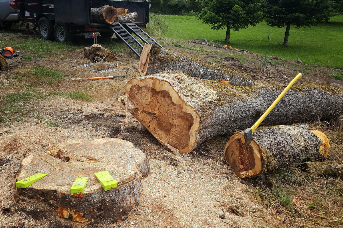

    My buddy, that's him there, has a new mill, a nice 36" wide one, and when I saw a Craigslist Ad for a "Free Apple Tree" I sent it to him. The limbs (in the ad photo) looked about 8 or 10" thick - so no problem, right?
    Here's what we found: a century old apple tree some 32" at the base, with three humongous limbs each at (perhaps) 18" in Diameter and about 12' tall. Now, maybe this happens to you all the time, but it was, by far, the biggest Apple tree I'd ever seen, much less harvested. Here in Oregon, on a river bank.
    It took everything we had, and I do mean everything, to get this all loaded.
    And yes, while I am ashamed of my back cut - a bit under-gunned with a 25" bar and some obstacles to avoid, the picture does nicely show there was some cool spalting (and some plain rot), still - I think he's going to be thrilled with some of the slabs he gets - hope so anyway! The rest - all burns. Right? Take care Friends!

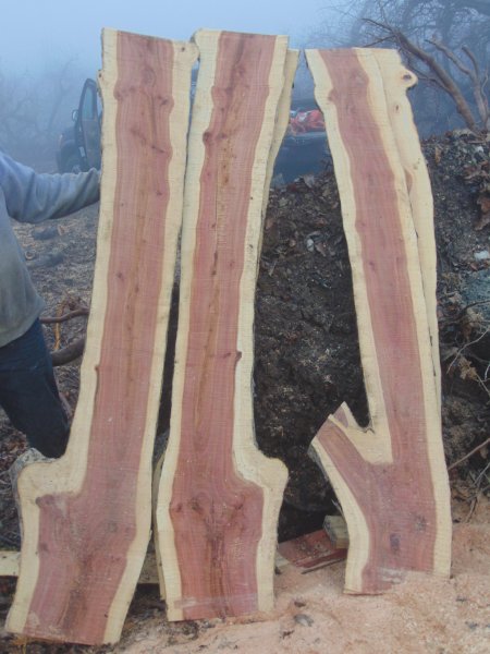

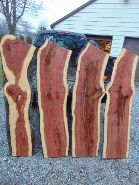

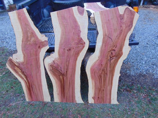

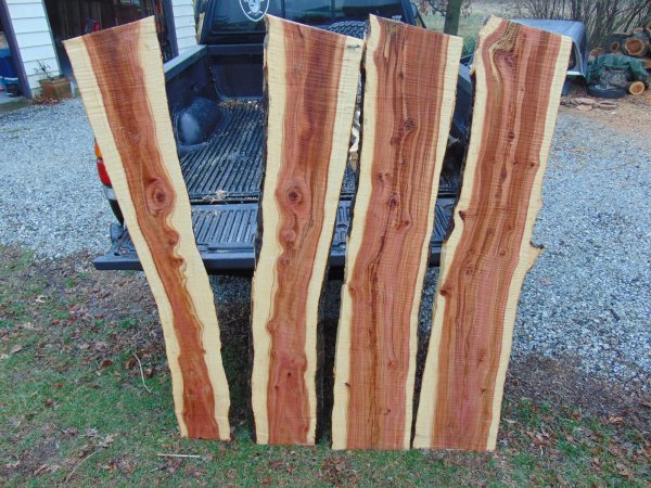

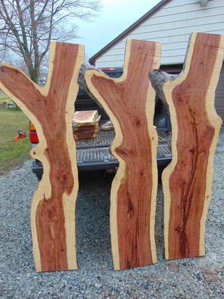

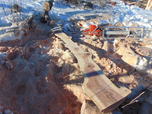

    I have processed hundreds of apple trees, milled a bunch too. The stuff really twists like a pretzel when it dries. Tell him to ratchet strap and top weight (heavily).
    Shame about the rot. I don't think you'll see a tree from about 40/45 years and older without some.

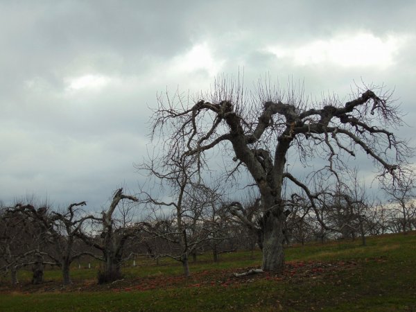

    Some of the oldest in my area are only know to be about 50. The orchard owners typically doze and replant by then. DSC00906.JPG

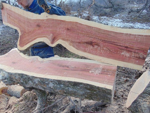

    Sure can produce some pretty color.

    Those slabs almost look like red cedar. I had no idea apple was/can be that color.

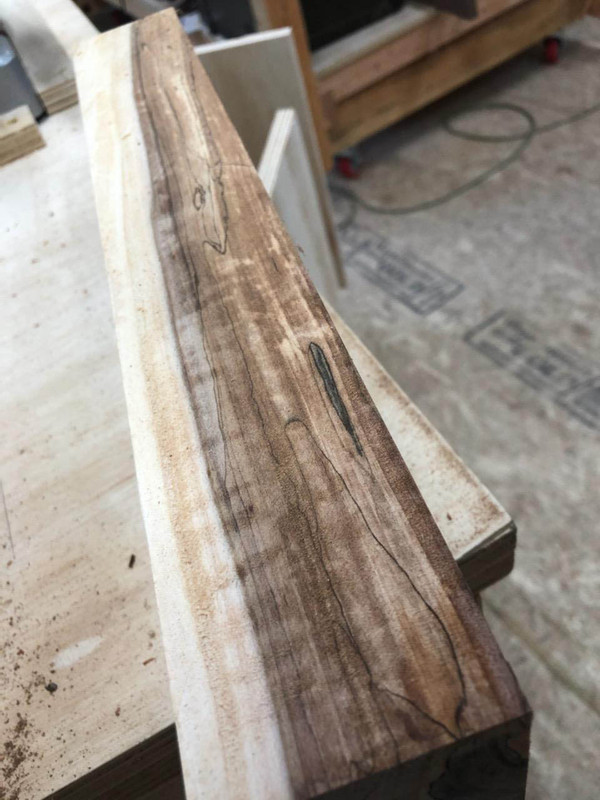

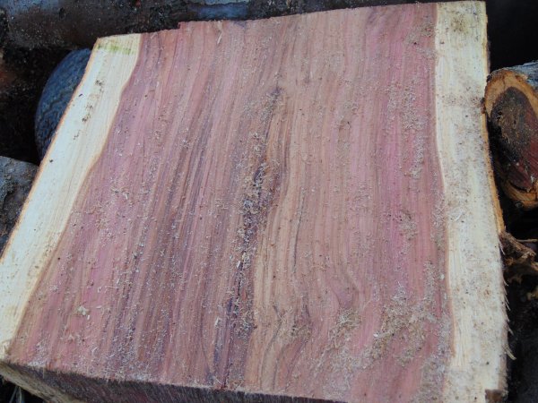

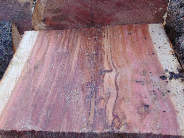

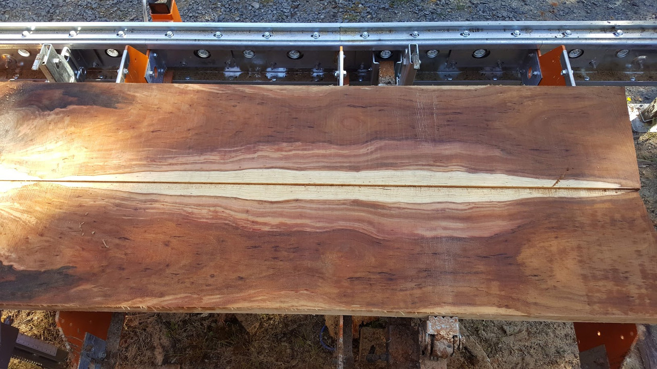

    Here are some photos of the first milled wood from the above Apple tree. These came from some of the "firewood" pieces, the main logs have not been milled yet.
    Honestly we are both stunned by the depth of colors and spalting pattern.
    This wood is very solid, and currently at over 30% moisture content.
    The ends of the big logs have been sealed.
    This tree was still alive when felled.
    So what do you think?

    Here is a match of nine quarter apple which are 12" wide, still just a limb - not the main trunk.

    That looks amazing, I never knew apple looked so good.
