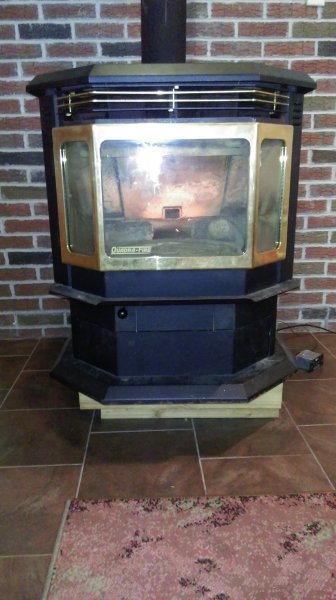

    OK...here's deal:
    Stove is very dirty in the back.
    Convection blower is id loaded with dirt and hair, definitely not cleaned in a long while
    Hopper lid hinge is broken about 3/4 across the hinge
    It started to feed pellets but then stopped, he needed to hit reset to feed them again. I noticed the pellets were bridged in the hopper not sure if that had anything to do with it.
    This past season his BIL replaced two of the snap disks, are those supposed to sit flush? One looked like it was hanging out a bit of where is supposed to go in.
    Fire started but then it stopped feeding pellets again, hit reset button pellets fed again. Flame was very low but convection blower started after maybe 4-5 minutes.....seemed like a bit.
    Flame seem to get pulled to the front of the stove but does have the fake logs in it.
    Based on firebox, stove looks like it does burn clean. No soot and light grey ash was in it.
    Once blower started there was a slight squeal that came from the convection blower
    Anyone have any idea what would cause pellets to feed then stop feeding other than hopper funneling? Reset button fixed it.
    Last but not least NO SURGE SUPPRESSOR ON STOVE.....oh, and it's up on blocks.
    IHATEPROPANE, smoke show and will711 like this.
  11. DexterDay
    DexterDay Administrator
    12,411
    31,637
    Northeast Oh
    The needing to hit reset, meant that the thermocouple didn't reach 500° on the allotted time. I'm betting that the thermocouple isn't touching the inside of the ceramic cover, and/or the ceramic cover isn't sticking out into the pot far enough for the flame to hit it.
    If the pellets were old, the flame may be small, or if the slide inside the hopper was to low, it would feed to little pellets.
    The motors and blowers will need cleaned and lubed, but based on your statements, I'd still be a buyer at $500-$600 and then a couple hours of elbow grease and it would prob be a good stove.

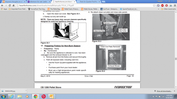

    As for the snap discs? You can download the manual for free to see how and where snap discs #1, #2, and #3 should be affixed
    IHATEPROPANE and slvrblkk like this.

    Thanks....I'm looking at the manual now. Right above the "remove 4 screws" in the pic, right above the number 4 is the snap disk that was sticking out. I'm thinking of throwing a $400 price at them and see if it flies. He did say he wants it out of there, not sure if he was giving me a hint or not.
    IHATEPROPANE likes this.
  13. DexterDay
    12,411
    31,637
    Northeast Oh
    That snap disc is held in place with a small clip. But it should be flush against that exchanger housing/exhaust path.
    If they don't use it? And want it gone? $400 would be a fair price
    If they used it and were replacing it? Then they would probably want more out of it.
