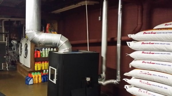

  7. DexterDay
    DexterDay Administrator
    12,411
    31,636
    Northeast Oh
    It's a little dusty.. Have not wiped it down yet. Still performing some work on it.. :)

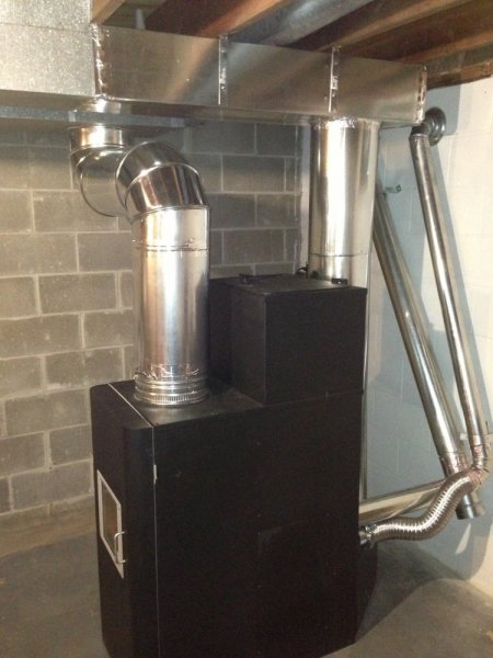

  8. 343amc
    343amc
    1,749
    5,770
    Northeast Lower Michigan
    Here's how I hooked mine up. This was right after I did the install and before I insulated the ductwork.
    wildwest and DexterDay like this.

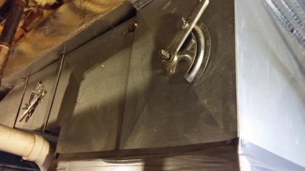

    So if you used your existing ductwork then you had to installed a damper abover your existing furnace right?
  10. DexterDay
    12,411
    31,636
    Northeast Oh
    From my above post.
    I had these installed by the same people who ran the insulated ductwork. They also inspect my air conditioning every Spring :)
    wildwest likes this.

  12. Triple A Arsenal
    Triple A Arsenal
    Sep 25, 2014
    710
    1,320
    New Haven, CT
    Hey you have lots of laundry detergents, are you a couponer?
  13. DexterDay
    12,411
    31,636
    Northeast Oh
    My wife is.. :D
    There is more of where that came from... A lot more..

  15. Triple A Arsenal
    Triple A Arsenal
    Sep 25, 2014
    710
    1,320
    New Haven, CT
    My wife noticed that when I showed her the furnace pics. She wants to do that too but doesn't understand it.
