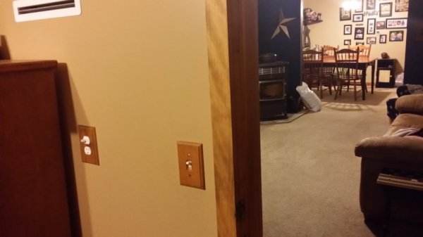

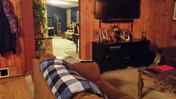

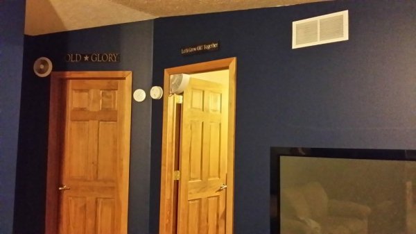

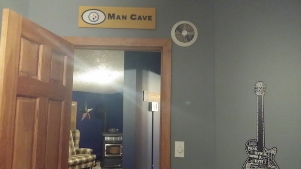

    The 1st pic shows both vents going into the room. Our Master has the rectangle vent above the t.v. and my son's is a circular vent.
    Ours is a Tjernlund Aireshare. It's was over $100, but it's very quiet and works well. It uses the studs in the wall as an air cavity. So you can place the inlet and/or outlet wherever you want. I placed the inlet up top, and the outlet about half way down the wall in our room.
    My son's is a Broan (model #512? I forget now?) It was only around $45 and moves more air than the Aireshare, but is much louder (when full tilt/it has an adjustable switch to control the rate of speed) It's an in line unit, so it's a straight shot through the wall.
    Both work as advertised. If I had it to do again? I would have put the more expensive Aireshare units in all the rooms.
    Welcome to my home.. :)
    Showing both inlets...
    Here is the outlet in our room. Further down the wall. The stove room is on the other side/stove is visible.
    My son's outlet. .

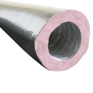

    What's the insulating sleeve?
    jtakeman likes this.
  11. jtakeman
    12,306
    55,475
    wildwest likes this.
  12. Triple A Arsenal
    Triple A Arsenal
    Sep 25, 2014
    710
    1,320
    New Haven, CT
  13. jtakeman
    12,306
    55,475
    Yes, Only works on the smaller 4 to 6 inch flexible duct. I used a similar wrap for the larger duct.
