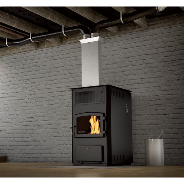

    Is there a place that is centrally located that you can install a free standing stove upstairs? My Enerzone can easily heat my entire home on its own, but with 2 small kids, it's easier to for me to run the furnace when it gets below 32° . It allows me to keep their doors closed and heat is blown directly into their rooms via the ductwork. Above 32° we use the Enerzone upstairs.
    I also installed through the wall fans, so in the event that the furnace is down, or I am to lazy to go downstairs, I can turn on these fans, and still heat the rooms, while still having the doors closed. We are a doors closed at night family.
    If you need pics or info on the through the wall fans? I can supply those later tonight.
    Also, as Jay suggested, the Drolet Eco-65/Enerzone Euromax, or Enviro Maxx have a ducting kit. This allows 2 ducts (4"?/5"?)to be ran to other locations in the house, while still having around 30%-40% of the heated air still come out of the front of the stove, and the other 60%-70% supplied to the 2 ducts.
    You could probably stop kit those 2 ducts into two ducts (total of 4). The airflow would be reduced, but more areas would get heat. Check with the manual before taking that as truth though.
    Here are 2 pics (not mine/Google image search).
