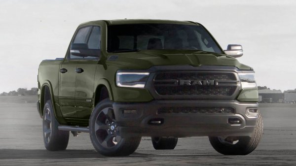

    So I traded in my Ram 2500 and downsized to a Ram 1500 (the reasons are irrelevant however when I saw the Tank-colored limited Built to Serve Marine Corps edition I was like ooh, shiny object....).

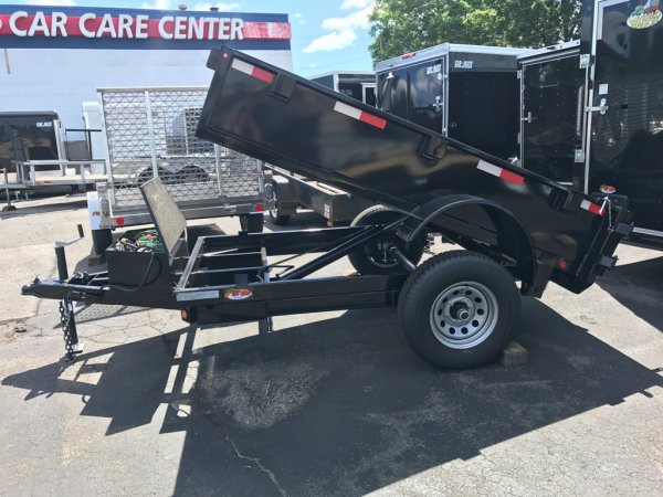

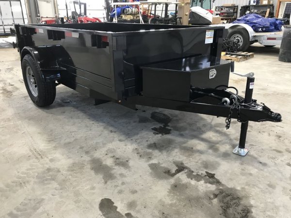

    The truck has the 5.7 Hemi, 4x4, and locking rear diff so hauling/towing isn't a problem (it is supposedly rated to tow 12,750 pounds) however I am considering getting a small dump trailer to save wear and tear on the truck. I'm looking at a something along the lines of the Griffin 5x8 dump trailer with a dry weight of 1,895 pounds and a carrying capacity of 3,305 pounds (they list gross weight as 5,200 pounds).
    Does anyone have or has anyone used one of the smaller single-axle dump trailers and if so, what was your impression? My main scrounging area is a narrow forest service road with limited turn around areas so I'm not looking for a full-size double-axle dump trailer.

    That’s a nice truck!!

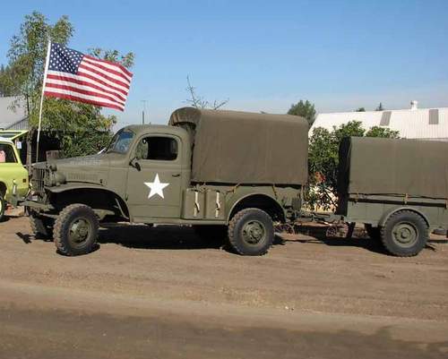

    I'd like to see the truck and trailer together, with those colors. :thumbs:

    The trailer I'm looking at has a 12-volt electronic-controlled single hydraulic ram for dumping the bed. A scissor lift is more ideal however with the smaller size of the trailer, I think the single ram format would be ok.

    You just had to suggest that :picard:
    Now I'm picturing painting the dump trailer to match the truck, putting military tactical markings on it, etc. Thanks....:doh:

    Had one something like this and used it for roofing for years. You could put plenty on it with the sides I built.. Liked it allot.[/QUOTE]

    My 6X12' tandem is rated at 10K with a single ram & I've not had any issues with it not dumping a load. I try not to overload it, but it gets used for sure.

    Same trailer for me. I love it.
    It dumps what gets put in it.
    And will carry a tractor.
    I think a 6x10 dual axle 8-10k would be a good size to have if not afflicted with dragging stray tractors home.
    I had a single axle 5x8 dump before I bought this one and it was real easy to overload that one 3500 lb axle. It seems like I only had room for about 1 ton payload. You lose some for the weight of the hydraulics, battery, etc.
