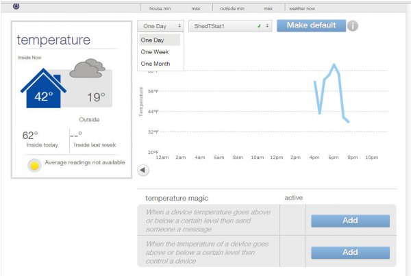

    I did have quite a configuration problem that took some time to figure out since this setup is all new to me.
    The problem was this:
    The iris hub was setup in the basement in the boiler room which is approximately 50 feet from the shed.
    This was not too much of a distance for the smart plug to work because I could turn the shed workbench lamp on and off no problem.
    It was too far a distance for the Iris T-Stat to work which made it tricky to figure out at first!
    Luckily I had run 3 cat 5e wires up to the livingroom which is on the side of the house next to the shed.
    So I moved the iris hub up to the livingroom next to my verizon mini cell tower and ShaZam it works!
    Therefore the location of the Iris hub is quite important.
    So now I am doing some full testing and it seems to be working just fine since the iris hub is approx 20 feet from the T-Stat ! ! !
    See pic 1 - Tstat control
    I like how it charts the temperature! :)
    I had the Tstat inside to pair it with the hub and add it to my list of active devices so that is why the temp went way down when I took it out to the shed! LOL
    I just turned on the Quad in the shed with the Iphone so the temp is on the rise, so now we will get some real data. Cool Stuff!
    See Pic 2
    Click pics to enlarge

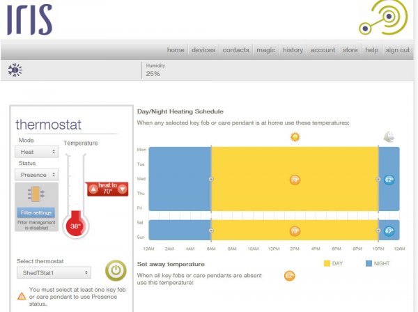

    Hello
    Had a little trouble getting the range extender setup for Z-wave devices, and since the T-stat is a z-wave device and winked out in the snow storm it is needed. The range extender initially had one bar and said Low Signal. There is a special pairing procedure that iris support girl is very patient and will help go thru it. Then the range extender properly read 5 bars and ok!
    The max range is 65 feet for the iris hub and another 65 feet with the range extender but it is radio wave and somewhat line of site so care must be taken to locate the hub and extender in prime locations.
    So it is working much better.
    See pic
