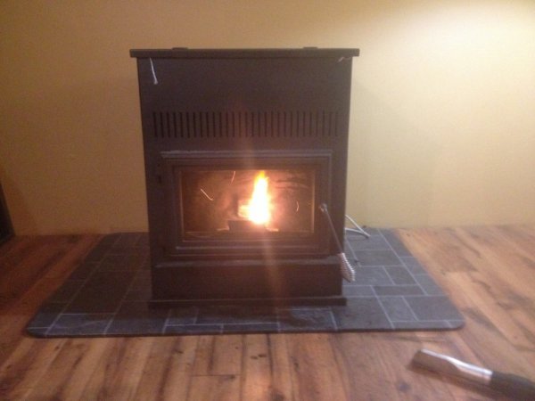

    Well I Disassembled the chimney and cleaned it out with brush again on vertical. I then used shop vac with just it's plastic pipe, which gave me a good fit inside of horizontal run and sucked everything out I had loosened up. It did not appear to be that dirty. I then cleaned the stove again. Keep in mind this is a brand-new stove. I took this picture to show the glass at start up. The last time I cleaned the stove, just before I started this thread about this problem, the glass was also this clean. But within a matter of 4-6 hours the glass was extremely dirty. It was like it was sticking to the glass. When I cleaned it this time the stuff was stuck to the glass like muck. I am wondering if there was something wrong with the pellets.

    There seems to be no problem with smoke getting out chimney. I am still wondering if it could be these pellets on a low setting of 3-3 was not good. Just too slow of a burn. Not a hot enough fire. ? I don't know. I am not happy that I can not get to the horizontal run for cleaning. Poor design as far as cleaning goes. I hate to say that because I like the stove. But I can not get to important places to clean. Why? And I should not have to buy a leaf blower to clean my stove!

    What pellets were you burning? Are you burning something different?
    Is the flame still very active and your getting little sparks flying constantly?
    Have you tried to raise your LBA? Bump it up one or two of your getting excessive pellet or ash build up in the pot.

    What prevents the flames from going up the auger path and starting a fire in the hopper of this stove? Does the air come down the auger channel and Because that is what I was concerned with when I started this thread. The pot had overflowed with pellets, apparently from them not burning through and/or clinks/whatever. And when I knocked them down I realized they had literally backed right up the auger path. The ones trying to come down could not. Yikes!

    Burning Timber Heats.
    Flame seamed okay. A little more active now, I just turned LBA up one notch to 5. Settings now at 1-5-1 on lower three adjustments. Other two, heat range and blower speed on 6-7.

    If you see ANY indication of pellet build up (more than what it looks like during normal burn, and after the cleaning), I'd raise the LBA to 6.
    According to Mike H., the max anyone should go is 7....more than that and the heated air just goes through the stove too fast and doesn't have enough time to heat the exchanger.

    The vacuum in the stove should draw air down the auger chute. Even though the hopper is supposedly sealed (yeah right), air would still rather come down that chute than up. Remember, the stove is creating vacuum whenever it's running. Whenever the exhaust blower is runninf, air is constantly being drawn in to every hole, crack, leak, etc.
    Is the problem you had not significant? No. It is. I would be looking at the flame, ash build up, glass color, ash color, and any other thing that you can note that may be different than before.
    A darker ash, more build up in the pot, and all the other symptoms above are all indicators that there is a problem.
    It could have been some old Moist pellets. Wet pellets will cause havoc on a system.
    Hope you get it straightened out. That stove should be able to burn several ton without a significant cleaning (especially the very 1st season) .

    Timber Heats fed FAST for me....this may be part if your problem....your level 6 may be more like level 9.
    For example....most pellets feed at around 2.2 lbs per hour on low for me. The Timber Heat were over 3 IIRC. Roughly 35% faster than "normal"

    That is a little concerning. I left the stove on 5-7 I think. Hope it is alright. It was burning great when I left. I had turned the LBA up to 5. We will see in the morning.
