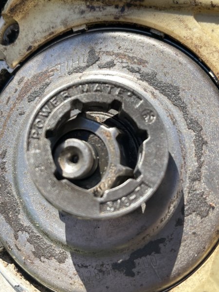

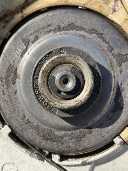

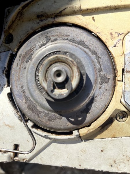

    Here you go:
    As it sits…
    Small Screwdriver to remove. Keep finger pressure on it… Has been to disappear in a jiffy…
    Then remove the out retainer washer …
    DBA5539B-11B2-45F6-B1FF-BD3BBB118012.jpeg 40383DEA-2DE9-417F-A81B-8A8C2E3D729F.jpeg
