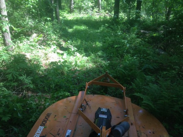

    Thanks for all your replies, I will post a few pics in this thread of some cutting. I need to get out of wood splitting in the heat for several hours this afternoon when it is the hottest. Good time to do some cutting.

    It's cutting nicely. Yeah! This use to be a trail! Boy it is starting to look like a jungle in here in the three milder seasons. Tim to come through with the pile saw and widen things out, let the sun get in here and dry things out as well. Lots of wet spots.

    Looks good gasman! Those things can be a real pain sometimes, glad your up and running.
    Is that a 5 or 6 footer?

    Thanks concrete grazer! 5 footer. I still have some adjusting to do to it but it is working nicely.
