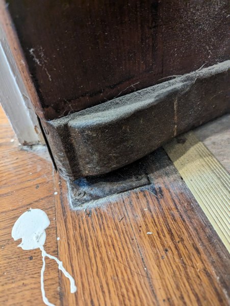

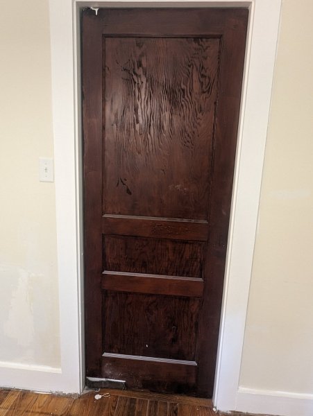

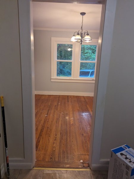

    The house I'm working on has one of these "Murphy" doors I think I've heard them called. I need to remove it before I have the floors refinished. I'm not worried about reinstalling it because I want it open between the dining room and kitchen. I'd rather not butcher it up if I find someone who wants it locally. Thanks in advance.

    Might try pulling the screws at the bottom and see what happens

    Looks like the bottom plate is some kinda "clamshell" for the lower stud/pivot?

    I don’t believe I have ever taken one of those doors apart so looking at it I am thinking at the bottom you could try pulling the screws on the clam shell or try taking the screws out of the floor your other option it looks like you could take a sawzall and metal blade and cut between the door and the door frame at the top

    Don't you just pick up and pull the bottom out?

    That is my thought too.

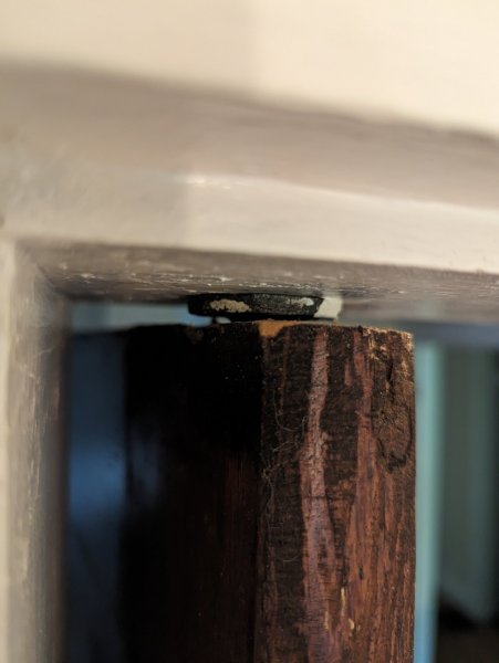

    That was my guess. We have a door similar and that's what I do with it. Bottom has a threaded piece you can turn in to get some slop in it.

    Finally got a minute to work on removing the door. I stopped by the house after work yesterday...it was the easiest door I've ever removed in my entire life. It was only the 4 screws then slide it out. I thought surely there was more than that. Thanks!
