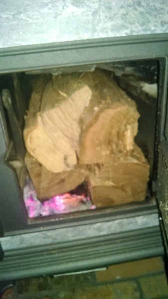

    Yesterday I loaded up my 4 splits of Black Locust on some hot coals on a 200° ST.
    11:30am loaded
    11:45 engaged cat, air at #2 CT 600
    12:15 closed air .5, ST 380, CT 1250
    1:00 ST 520, CT 990
    2:00 ST 520, CT 1110
    3:00 ST 570, CT 1035
    4:00 ST 460, CT 850
    I left the house for dinner then went to my pool league and didn't get home until 11:00pm. ST 250, CT 480, still was plenty of fuel so I let it go and went to bed. At 8:00 am the ST was down to 170, CT 320, had enough coals to reload four more splits and repeat.

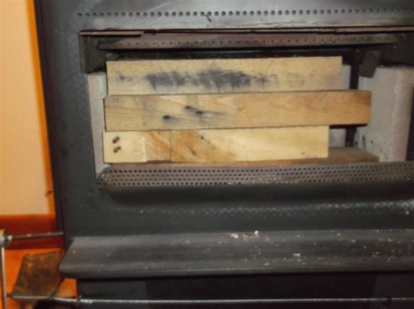

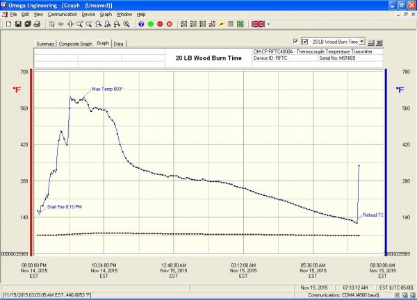

    Here are my results from last night. Loaded 8 pieces of 2 x 4 oak pallets (about 20 lb), just about all that would fit in my 1.4 cu ft fire box on a small coal bed. It did take a bit longer than usual the get the wood going as it was packed tightly together. Started at 8:00 last night, and this morning at 7:00 still had a few coals left.
    BTW graph from Omega wireless data logger.
    Goes to show that if you have the right kind of pallet wood you can get some good heat/burn times.
