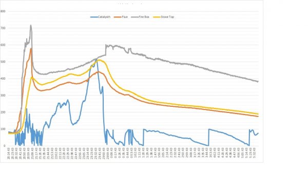

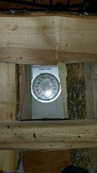

    28 lb (2).jpg This is a 28 lb run. It seems I had a failure of my catalyst sensor as you can see by the lack of temp. I engauged the catalyst at a flue temp just under 600* and st draft to 1/4 open and walked away. View attachment 73510

    Odd how it keeps bumping up to 100 then falling back down. Still too warm here for running any tests; I'd like to have decent draft before dialing my stove down low. Will put up a results thread in a couple weeks ... it's got to be cold enough by then (I hope).

    That catalyst probe is positioned directly in the middle of the opening that the exhaust flows threw. That initial fluctuation is the flames starting and fluctuation causing the spikes. Once the catalyst is engauged the exhaust is forced threw the cat and then the reading is directly above the catalyst and would have normally read significantly higher and much steadier. Or that was the beginning of the sensors failure.
