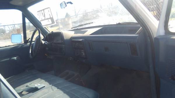

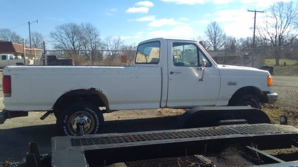

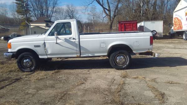

    Here is a 88 f250 I was goin to look at before the Chevy... A company has owned it since new, and it was there plow truck for their lot..... I have not went to go look at it, so I haven't got to see it up close or drive her yet....guy said it has a 302, which I figured it would have had the 351.... Anyway I don't know if I would want to get one this old, it has 88,000 miles....they have $1900 on it, but obviously with cash in hand who knows what they would take....chances are it would have rusty frame, and leaf springs would inevitably probably need replaced....but like I said I haven't seen it so who knows..... I just think I should maybe try and get something newer, but I guess if price is right maybe she would be an option?????
  4. brenndatomu
    25,088
    162,969
    If that 88 has a 302 then it is the light duty 250. Nothing wrong with that...just know it is not gonna be 8600# (or 8800) GVWR with full floater axle like the HD 250/350. It's basically a heavy duty 1/2 ton. They did the same thing with the newer trucks too ('97 and up) but it is easier to tell which is which because the light 250s are the same body style as the 150 and then heavy 250 and up are the "Superduty" body style.
