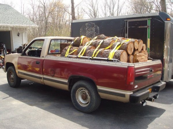

    Hey thanks Redfin, that's a nice rig you got there!!!'

    Hey mastermech, good to see u agian lol.... Hey how long have you owned your 3500, and how many miles do you have on her....is it a dually.... I haven't bought the truck yet but when I go to look at it and drive it, if it drives like the guy says I will definitely be buying her.... with that 1-ton suspension Do you think I can put as much wood in that bed as it will hold, and maybe pull a trailer with wood too.... I met a guy that has a tree service about 20 miles from me, and he needs his lot clear, so he said I can come load every damm log he has.... I think this truck will be perfectly capable of that, what do you think mastermech????.... Also mastermech this truck has 83,663 miles, and has a boss plow mount, do you think $3500 is reasonable, obviously if it is in good shape....Sorry for all the questions I just know you know your chit!!!!!!
    I tell ya I am so damm sick of my F250 I am getting rid of it as soon as I can..... Had her running great and put a brand new power steering pump in, and then 2 damm days later I cant get her to start agian, so pizzed off about it I don't want to think about it or look at it...

    Known this truck since 2003 or so, owned it since 2012. 80k on the clock. Grew up with an '89 K3500 ext cab single rear wheels. We bought it with 30k in '92 and ran it until 2003 when dad traded it for a new DuraMax. 160k on that one. Also drove a '94 3500 roll-back with God knows how many miles for a few years.
    Why yes, I think you can load'er up without fear. You will want good trailer brakes (both axles...) if you are loading both the truck and trailer tho. Note that the suspension on a SRW is not the same as a dually. I don't know about '98 but on mine, I have a Dana 70 under the rear while the duallys came with a Dana 80 or a 14 bolt.
    Price is good if the body and frame are clean and in good shape!

    damm mastermech, always love your replys, always detailed, and helpful, thanks man.... Yea he says she is clean underneath, but I will know for sure today or tomorrow... Wow 160k sounds like you guys got some good use out of her.... Would be very pleased to get that mileage from this 98 if I buy it.....ya I don't own a big trailer yet, I have one I can use, but I will definitely be lookin to buy one eventually..... Is that your truck in the pick ...... Hopefully this truck already has the tow package on it, I would think it would being a HD truck...
    Will let you know how she looks in person and how she drives soon as I go look....
